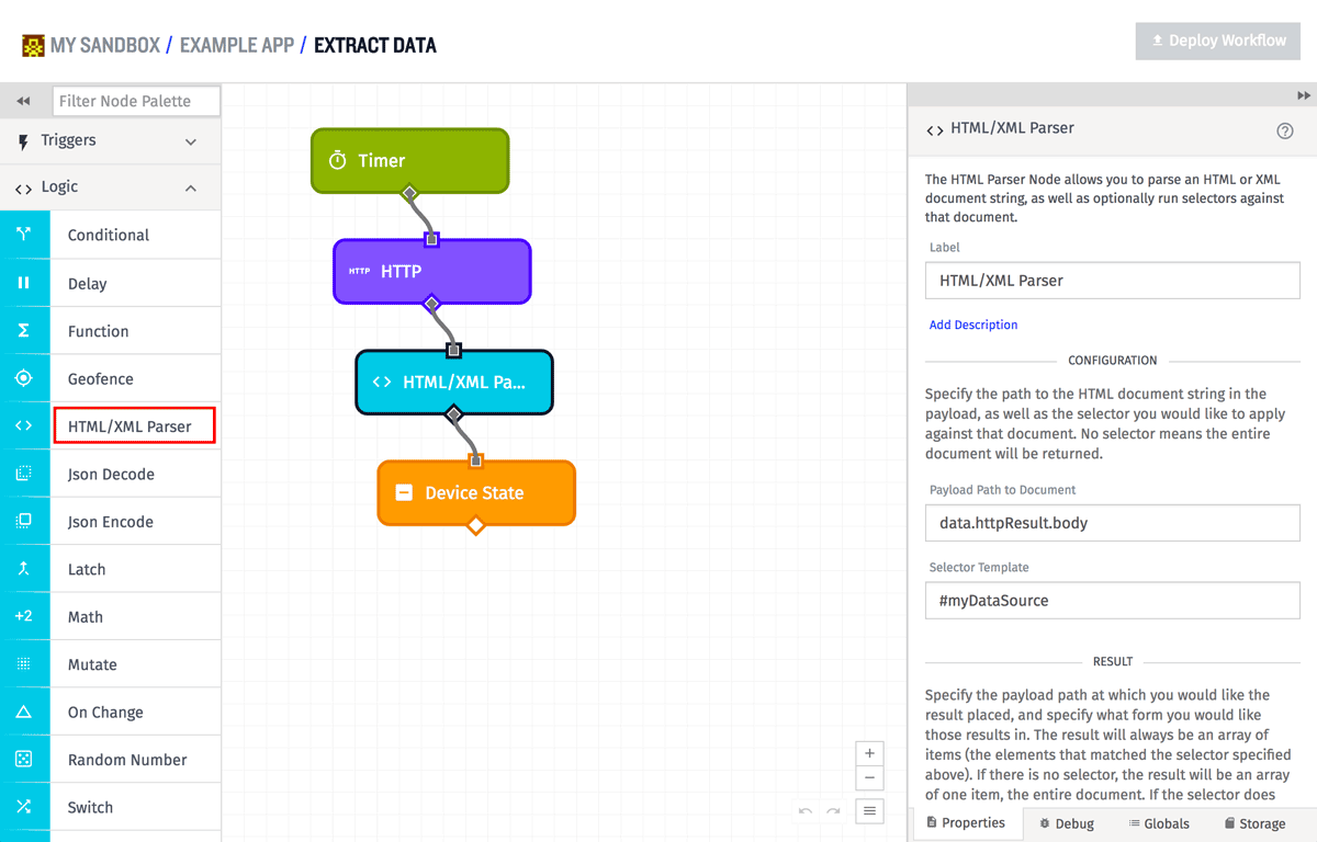

For determining what to parse, the node needs a JSON payload path, which is expected to point at a XML or HTML document string. The node will take that document and parse it as best as possible - obviously a well formed document is preferred, but the node does attempt to deal with documents that have structural or syntax errors. By default, the node will use the entire document for the result, but a selector can be defined to reduce what is actually returned from the parsed document. The selector uses standard CSS Selector syntax. Invalid selectors will be treated as if they match nothing in the document. Selectors that match more than one section in the document are also valid.
In the above example, the node is pulling the HTML document string from the data.httpResult.body path (which in this case is storing the body of a webpage retrieved by the previous HTTP Node), and applying the selector #myDataSource against the document (which will pull out the node that has the ID myDataSource).

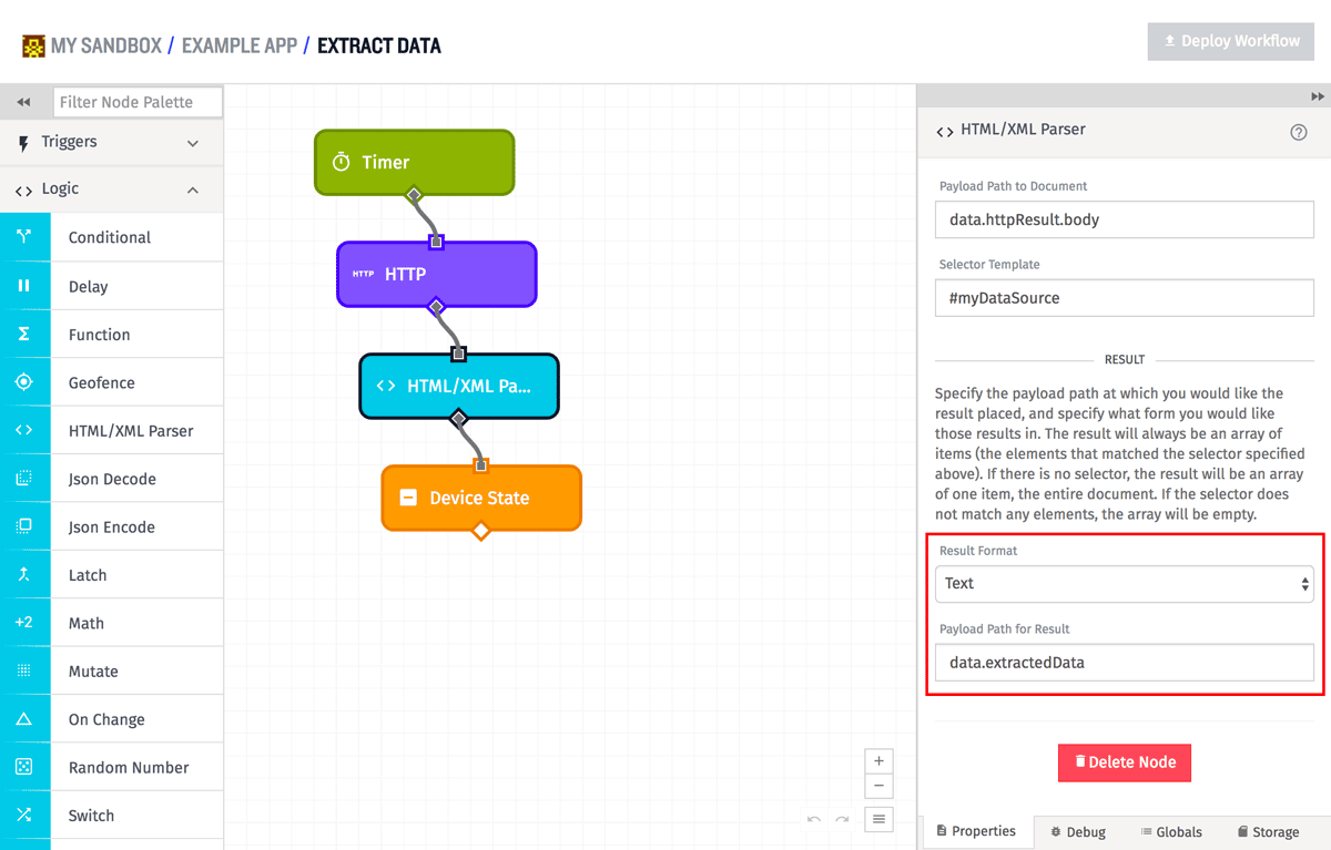

Once the node has the parsed document and has applied the selector, it needs to know where to place the result on the workflow payload, and what form that result should take. Where to place the result is just a simple JSON payload path. In the example above, the result will be placed at data.extractedData and will be in Text format.
