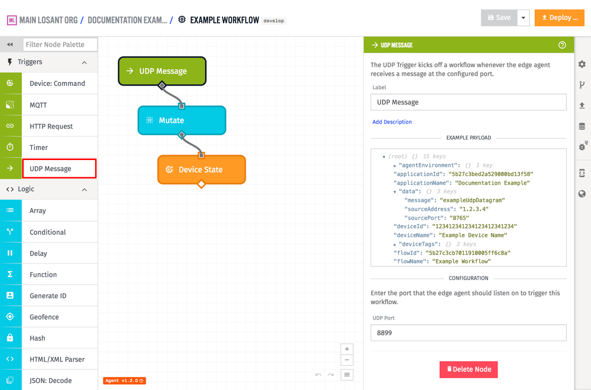

UDP Message Trigger
The UDP Message Trigger will trigger a workflow whenever the Edge Compute device receives a UDP datagram on the configured port.
UDP Message Trigger
UDP Port​
The UDP Message Trigger has one piece of configuration, the port to listen on. When a workflow with this trigger is deployed to an Edge Compute device, the Gateway Edge Agent will open a UDP server on this port. When that UDP server receives a datagram, the workflow will trigger.
Payload​
The payload will include the triggering datagram under data object, which will include the following fields:
  • message: The contents of the incoming datagram.
  • sourceAddress: The source address of the incoming datagram.
  • sourcePort: The source port of the incoming datagram.
Given a UDP datagram received on port 45678 with the contents Hello, World!, a UDP Message Trigger workflow payload will look like the following:
