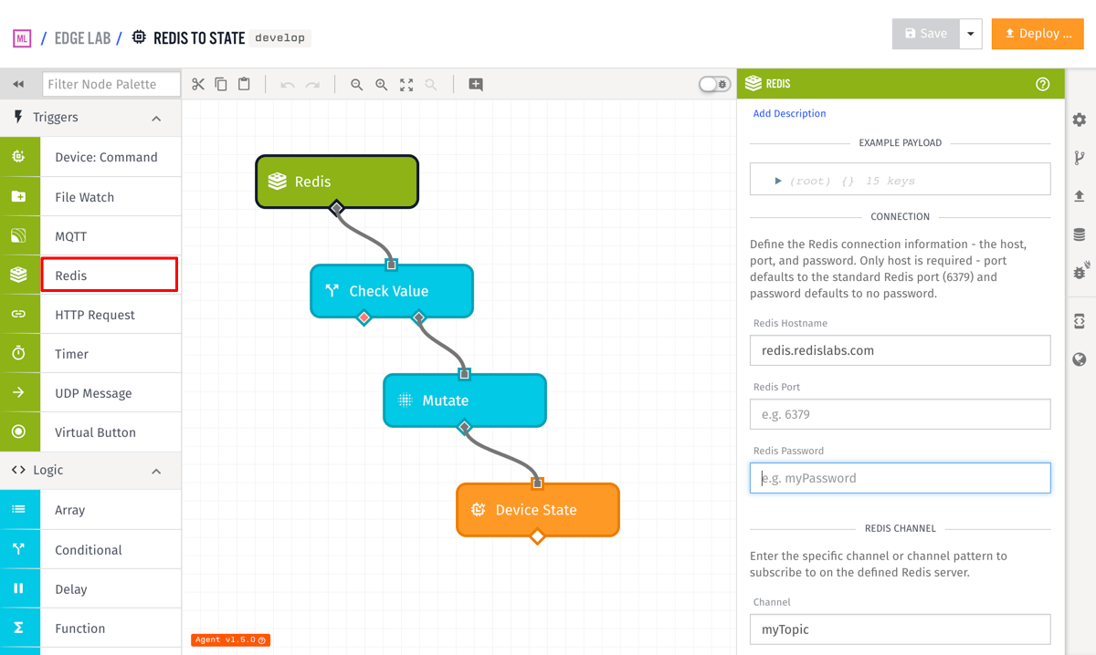

The Redis Trigger will trigger a workflow whenever the Edge Compute device receives a message on the configured Redis Pub/Sub channel.
Redis Trigger
There are two sections of configuration for a Redis Trigger.
Redis Server Configuration​
First, you need to configure what Redis server to connect to. You are required to provide the Redis hostname, and you may optionally provide the Redis port and password. If you don't provide a port, it defaults to the standard Redis port of 6379. If you don't provide a password, it defaults to no password.
Redis Channel Configuration​
Once you have the information configured for the Redis connection, you then must configure the particular Redis channel or channel pattern to subscribe to.
