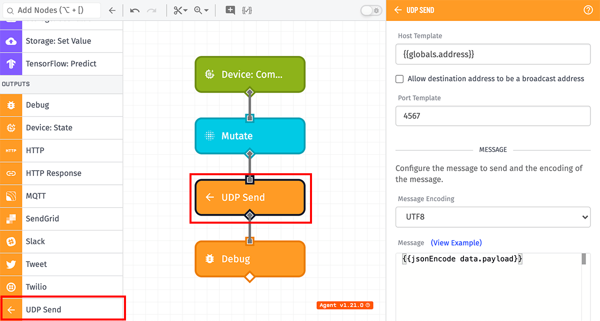

The UDP Send Node allows an Edge Workflow to send a UDP datagram to a given address and port.
UDP Send Node
Configuration of the UDP Send Node is broken up into three sections.
Destination​
  • Host Template: (Required) Enter a string template for destination address. This can be either an IPv4 or IPv6 address, or a hostname that resolves to an address.
  • Allow destination address to be a broadcast address: Starting with Gateway Edge Agent v1.19.2, you may elect to allow a broadcast address in the Host Template field (e.g. 255.255.255.255) if this checkbox is checked. Note: If you wish to use a broadcast address, the Gateway Edge Agent must be started in host network mode.
  • Port Template: (Required) Enter a string template for the destination port. This must resolve to a valid port (between 1 and 65535).
Message​
  • Message Encoding: Choose an encoding method for the datagram (defaults to UTF-8).
  • Message: Enter a string template for the contents of the UDP datagram to send.
Result​
You can optionally store the result of the UDP send on the payload for later use in the workflow. A successful UDP send will have the result { success: true }. A UDP send that results in an error will have a result of the form { error: <error> }.
