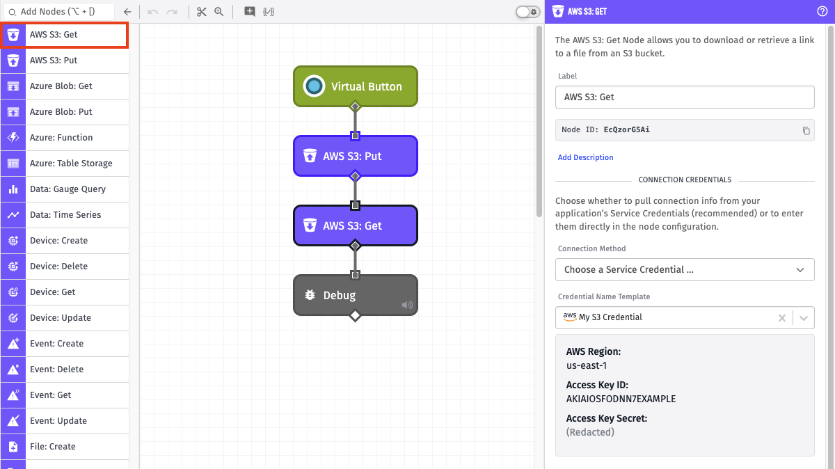

AWS S3: Get Node
The AWS S3: Get Node allows a workflow to retrieve a file and its metadata from an S3 bucket.
There are three main configuration sections for the AWS S3: Get Node …

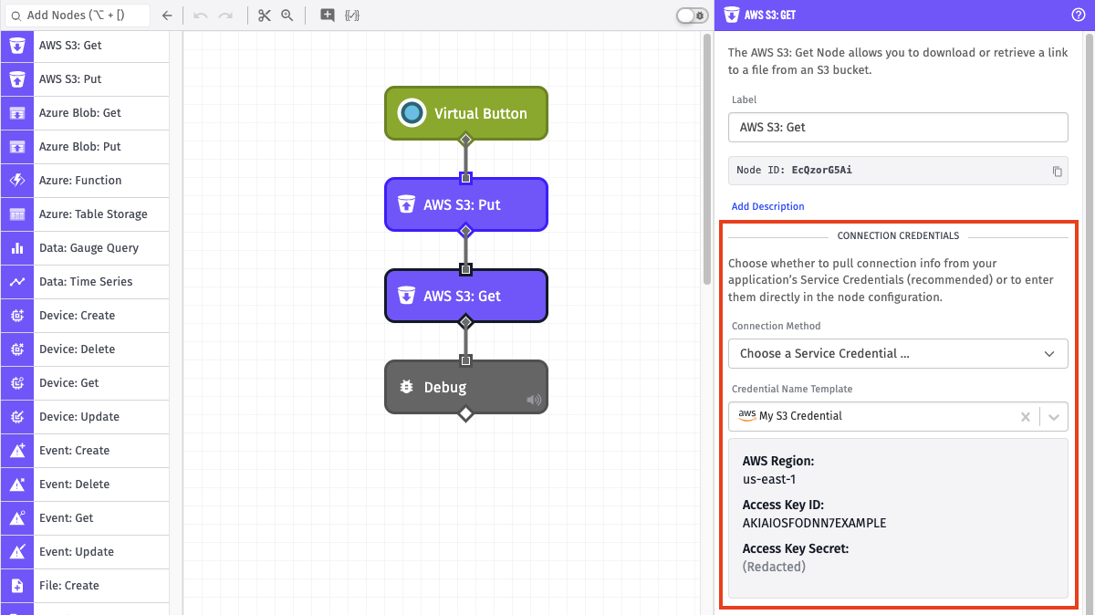

Credential Configuration
There are three parts to configuring credentials, and all of them are templatable:
- AWS Access Key ID (Required)
- AWS Access Secret (Required)
- AWS Region (Required)
We recommend that you create an AWS Key/Secret pair specifically for use in the Workflow Engine - keys that only have access to the proper AWS S3 buckets.
We also recommend that you store these values as workflow globals.

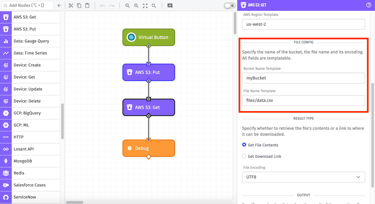

File Configuration
Next is to configure the fields required by S3. All applicable fields are templatable:
- Bucket Name: (Required) The S3 bucket where your file is located.
- File Name: (Required) The full path to a file within the specified bucket. Limited to 1024 characters.
- File Encoding: (Required) The encoding of the file that you’re retrieving. Defaults to UTF-8.

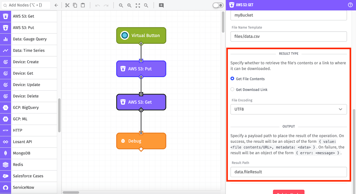

Result
Result Type: Specifies how the file should be returned:
- Get File Contents: Place the file’s data on the payload. Files retrieved by this method have a maximum size of five megabytes.
- Get Download Link: Place a link to the file on the payload
- Result Path: (Required) The result of the operation will be placed in an object at the specified payload path.
When the operation successfully executes, the result will contain two keys: the value
retrieved from AWS S3, and some metadata
about the file.
When the the operation encounters an error, the result will contain a single error
key.
The AWS S3: Get Node’s output varies with the selected result type:
When
Get File Contents
is selected, the result will look like the following:{ "value": "1, 2, 3, 4 12, 340, 360, 417 45, 318, 342, 391 56, 362, 406, 419", "metadata": { ... } }
When
Get Download Link
is selected, the result will look like the following:{ "value": "https://<region>.amazonaws.com/<bucket-name>/<key>", "metadata": { ... } }
In the case of an error, the resulting object will contain an error
key instead of the normal value
and metadata
keys.
"error": "Access Denied"
