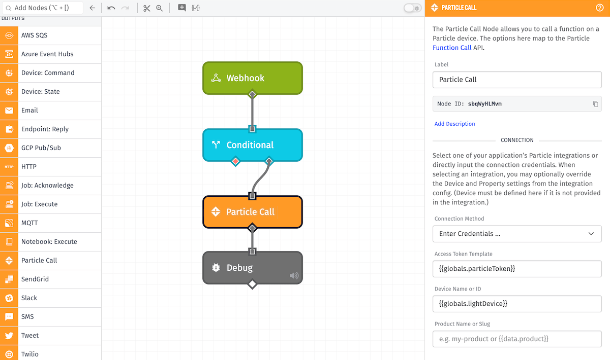

The Particle Call Node allows a workflow to call a remote function on a device within Particle.
Particle Call Node
Configuration for the node is broken up into three sections.
Connection​
There are two Connection Method options available:
  • Choose an Integration: Retrieves your Particle configuration from the selected Integration.
    • Integration: Choose which of your application's Particle integrations you would like to publish the message on. The ID is templatable. Note: Integrations are not accessible from Edge Workflows, so only direct configuration is available to them.
  • Enter Credentials: Configure the Particle connection directly within the node.
This section also takes the following inputs:
  • Device Name or ID: A device identifier. If it is not provided by an integration, then this field is required.
  • Product Name or Slug: The product that this device belongs to inside of Particle. This field is optional, and templatable.
