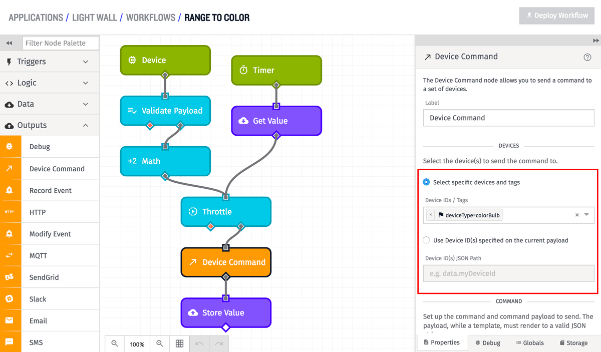

There are three parts to configuring a Device Command Node - selecting the devices to send the command to, configuring the command name, and optionally creating a payload to be sent with the command.
Sending a Command to Specific IDs and Tags​
To send a command to specific Device(s) by IDs and Tags, choose Select specific devices and tags in the Selection method... dropdown. This will expose a required Device IDs / Tags field.
Sending a Command to Device(s) by Payload Template​
To send a command to one or more device IDs off of the current workflow payload using a payload path templates, select Use Device ID(s) specified on the current payload in the Selection method... dropdown. This will expose a required Device ID(s) JSON Path field. This option allows a workflow to dynamically change what specific devices are being sent a command depending on the payload currently being processed.
Sending a Command to Devices by Advanced Query​
To send a command to multiple Devices using an advanced query, choose Select devices by query in the Selection method... dropdown. This will expose an advanced query input for defining which Devices to send the command to.

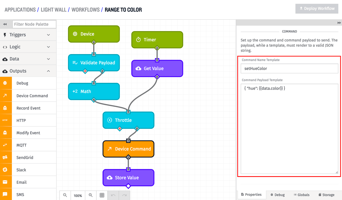

Configuring the Command​
The command name field supports string templates, so if the command needs to be dynamically determined, it is possible to alter the command based on the current payload. The command payload is optional, and depending on the needs of the command being sent, may or may not be needed. If the command payload is needed, it must be entered as a JSON template.
Device Selection​
Device Command Node Selection
In the example above, the first option is being used, and the node will send the command all devices whose tag deviceType is equal to colorBulb.
Command Configuration​
Device Command Node Configuration
In the above example, the Device: Command Node is sending the command setHueColor with a payload. And given the following payload:
"voltage": 1.7,
"color": 1393
The Device: Command Node would send the following command payload with the setHueColor command:
"hue": 1393
