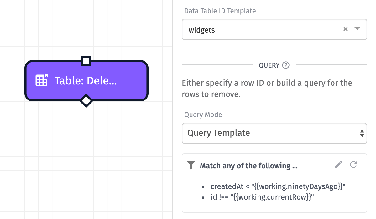

The node has three configuration sections - the data table from which to delete the rows, defining what rows to delete, and a payload path for storing the result of the deletion.
Table Delete Rows Node Config
There are two options for defining what rows to delete:
  • Row ID Template: Allows deletion of a single row based on row ID. The row ID field is templatable, and so supports finding a row based on the current workflow payload. The example above is doing exactly that, and is referencing the field data.body.rowId on the workflow payload.
  • Query Template: Allows building an advanced query using a JSON template. Rows that match the query will be deleted. When using Query Template, you can optionally specify a Limit Template to cap the number of rows deleted. This field is templatable and supports numeric values or Handlebars expressions. The default limit is 1,000 and the maximum is 10,000.
Table Delete Rows Node Query
