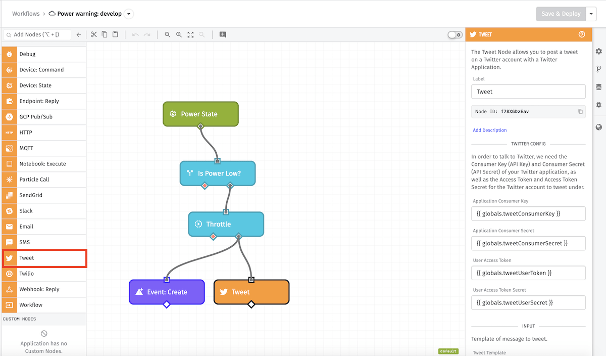

Twitter Config​
For the Tweet Node to work, Losant needs a number of different Twitter authorization keys. The Twitter API requires a Twitter Application in order to interact with the Twitter API. Each of the authorization values supports string templates, and most users choose to store these values in their workflow globals.
  • Consumer Key: The consumer key is generated by a Twitter Application. This field can be found at the top of the "Keys And Access Tokens" tab in the settings of a Twitter application.
  • Consumer Secret: The consumer secret is generated by a Twitter Application. This field can be found at the top of the "Keys And Access Tokens" tab in the settings of a Twitter application.
  • Access Token: This is the token is specifying the user account to publish the tweet. This field can be found at the bottom of the "Keys And Access Tokens" tab in the settings of a Twitter application, under the "Your Access Token" section.
  • Access Token Secret: This is the secret for authenticating the user account to publish the tweet. This field can be found at the bottom of the "Keys And Access Tokens" tab in the settings of a Twitter application, under the "Your Access Token" section.
