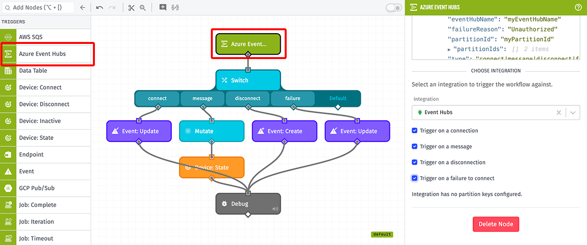

Azure Event Hubs Trigger
The Azure Event Hubs Trigger fires a workflow whenever an integration receives an Azure Event Hubs message or connection event on the configured partition keys.
The Azure Event Hubs Trigger requires choosing an Event Hubs integration, as well as at least one of the following events on which to fire the trigger:
  • Trigger on a connection
  • Trigger on a message (checked by default)
  • Trigger on a disconnection
  • Trigger on a failure to connect
