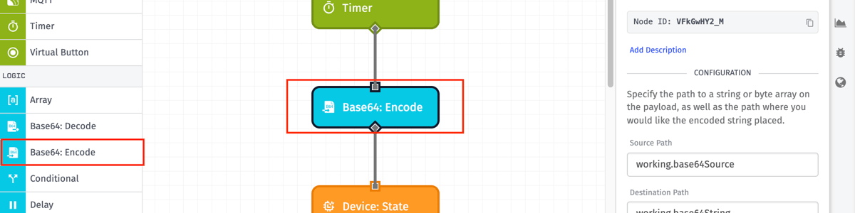

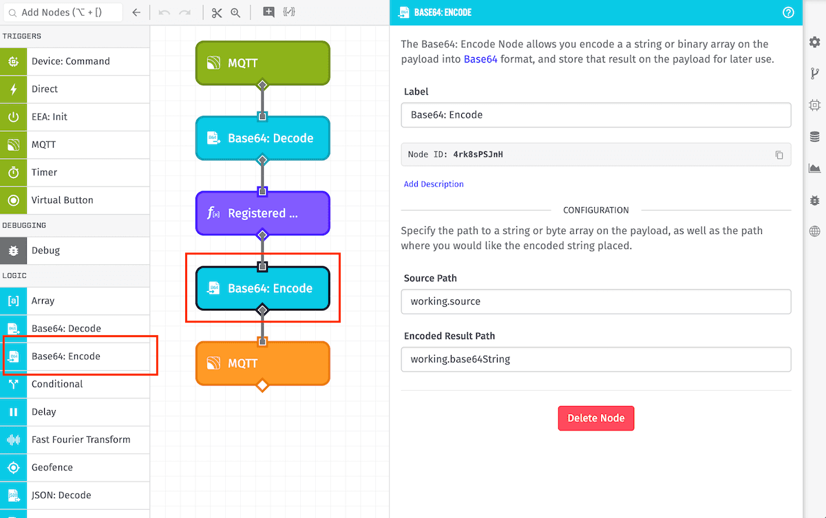

The Base64 Encode Node takes two properties for its configuration.
Source Path
First, enter a payload path to a string or binary array.
Destination Path
Next, enter a payload path where the result of the transformation should be placed. The result will be a Base64 encoded string.
