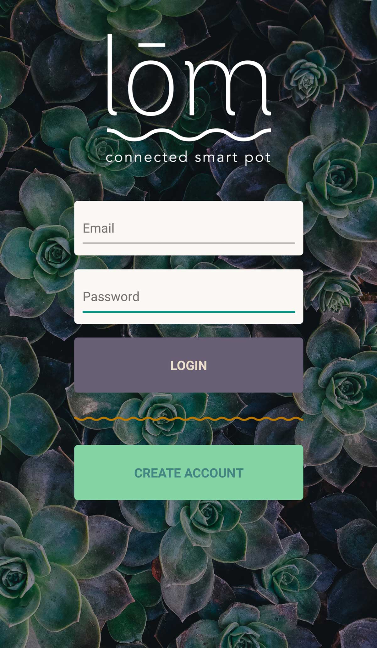

![Main Screen](/images/guides/how-to-build-an-experience-api/user-authentication/main-screen.jpg)

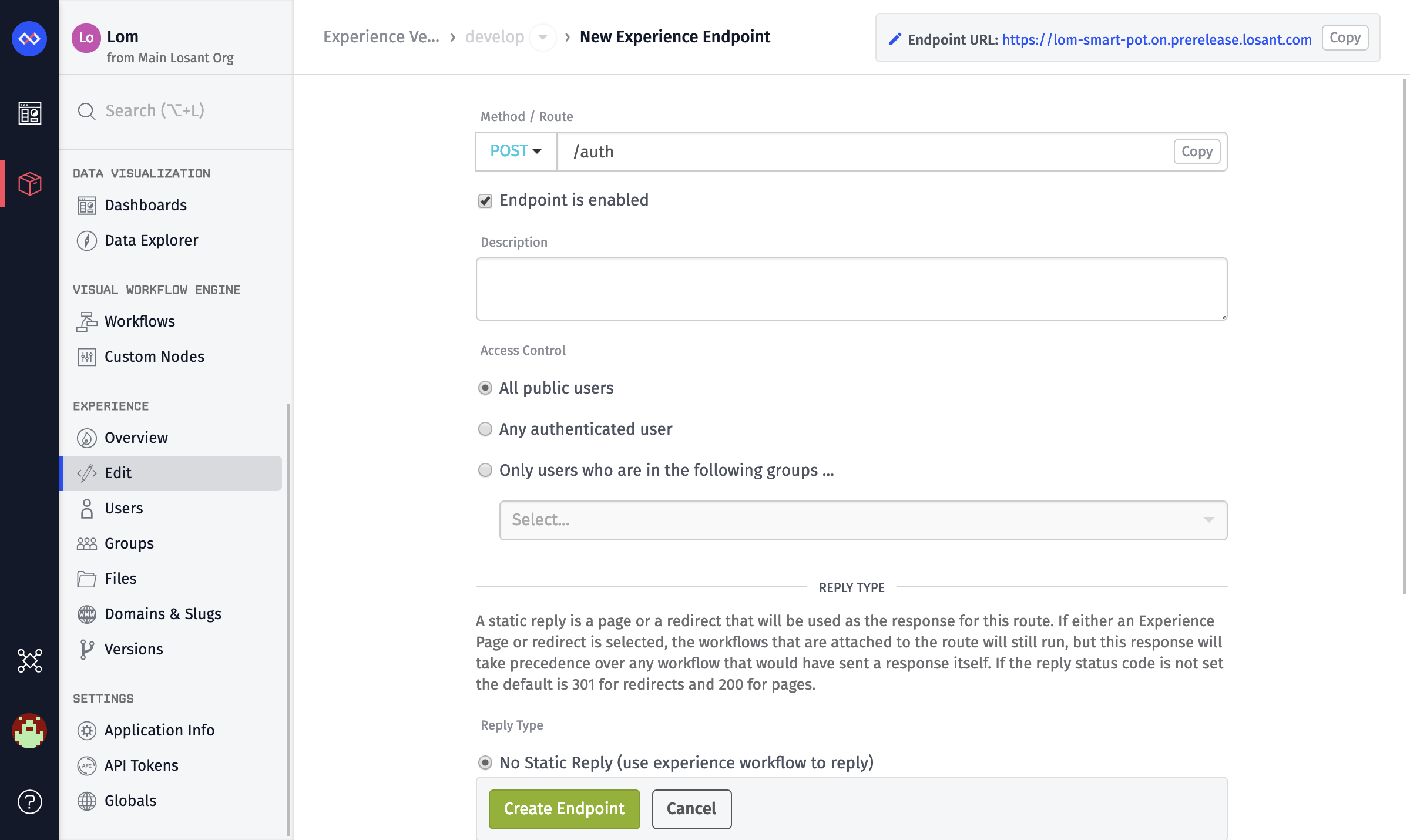

Step One: Create an Authentication Endpoint
We need to create an endpoint and a workflow that does this authentication. First, create a /auth
endpoint:
- Set the
Method
toPOST
. - Set the
Route
to/auth
. - Add a
Description
. - Set the
Access Control
toAll public users

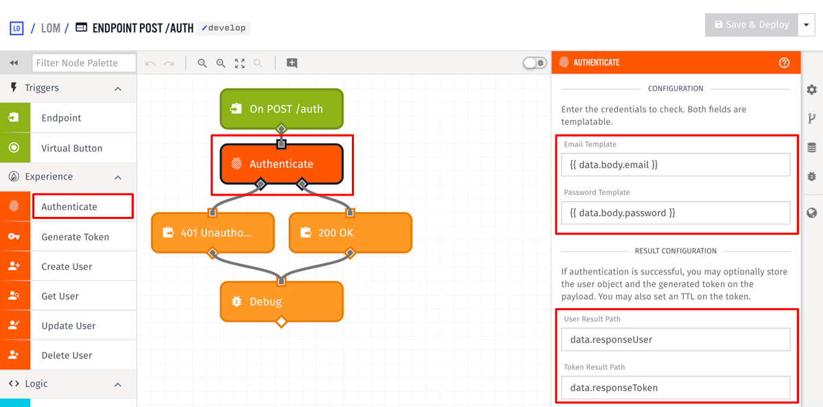

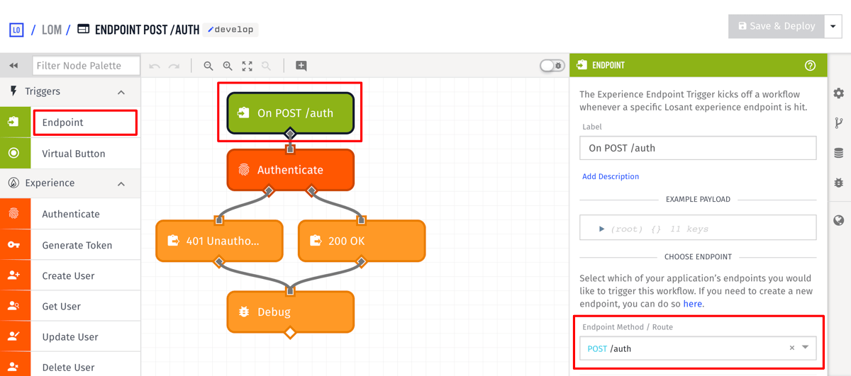

Step Two: Create an Experience Workflow
Next, create an experience workflow that handles the login requests for that endpoint.
Use an Endpoint trigger and select the /auth
endpoint that you created.
Add an Authenticate node, and configure it as the following:
- Set the
Email Template
to{{ data.body.email }}
. - Set the
Password Template
to{{ data.body.password }}
. - Set the
User Result Path
todata.responseUser
. - Set the
Token Result Path
todata.responseToken

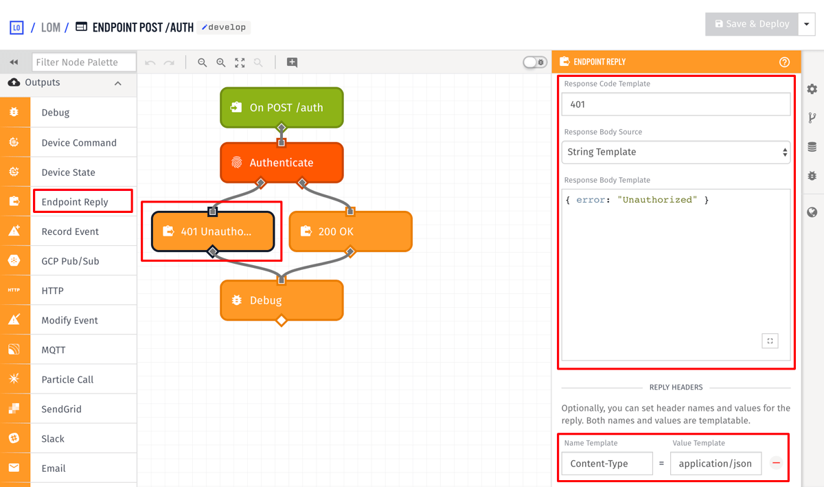

Add an Endpoint Reply node to the false
output of the authenticate node and configure it to the following:
- Set the
Response Code Template
to401
. - Set the
Response Body Template
to `{ “error”: “Unauthorized” }. - Add a
Content-Type
header with the valueapplication/json

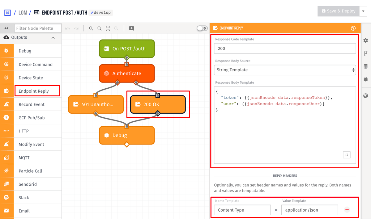

Add an Endpoint Reply node to the true
- Set the
to200
. - Add a
Content-Type
. - Set the
to:
"token": {{jsonEncode data.responseToken}},
"user": {{jsonEncode data.responseUser}}
The /auth
requires the user’s email and password to be sent as POST data. It then uses the Authenticate node to check if an Experience User has an identical email and password. If the authentication fails, a 401 (Unauthorized) is returned to the client. If the email and password are valid, the token and the user object, both of which are added to the payload by the Authenticate node, are returned to the client.

Now whenever a lōm user enters their email and password on the main screen, the client POSTs them to /auth
and obtains a token to make authenticated requests against the API.

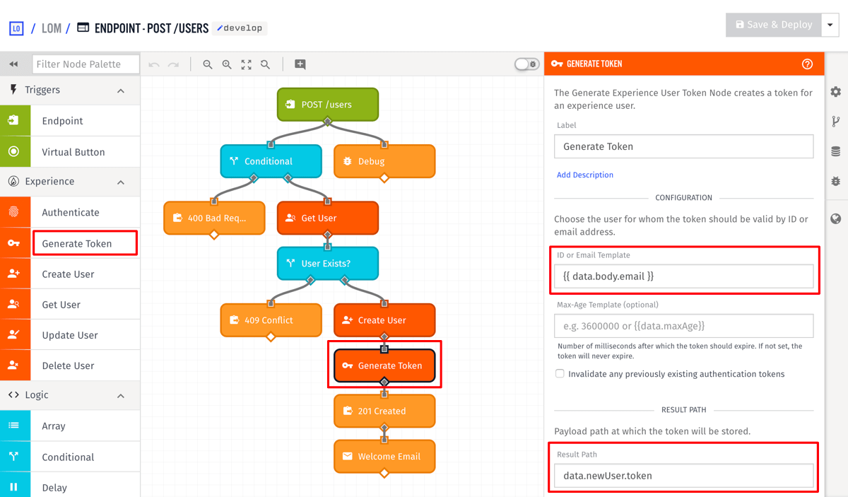

Step Three: Returning a Token
Using the /auth
route is the most common method users authenticate against your API. For convenience, modify the workflow we created in Part 1 to return a token whenever a user is registered:
- Add a Generate Token node and insert it after the Create User node.
- Set the
ID or Email Template
. The Generate Token node works by accepting the ID or email of an existing Experience User and then creating a token for that user. - Set the
Result Path
todata.newUser.token
This removes the need to register the user and then make an additional API request to get the user’s token.
As we saw above, the Authenticate node automatically creates a token, however, you can use the Generate Token node to create a token whenever you want. This provides a way to implement custom authentication mechanisms if needed. With this, in addition to the POST /users
endpoint, whenever a new user is registered, the client is returned the new user object and its token as the result.
