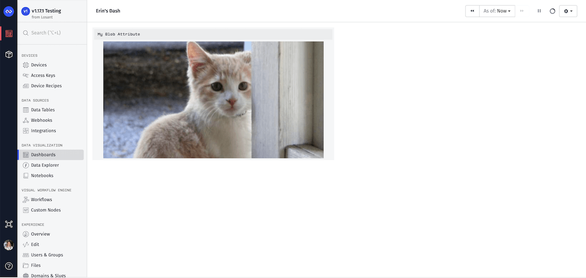

Images​
You can use Blobs to store images.
Blob On Image Dashboard
You may report your images as Base64 encoded strings. For example state report:
"data" : {
"image": "/9j/4AAQSkZJRgABAQEAYABgAAD//gA7Q1JFQVRPUjogZ2===",
"time": <Optional Timestamp>,
"flowVersion": <Optional Workflow Version Name>
While storing Blobs that represent images, you may use them in the Image Block or the Custom HTML Block within a dashboard. For example, this allows for your dashboard to display the most recent image of a device.

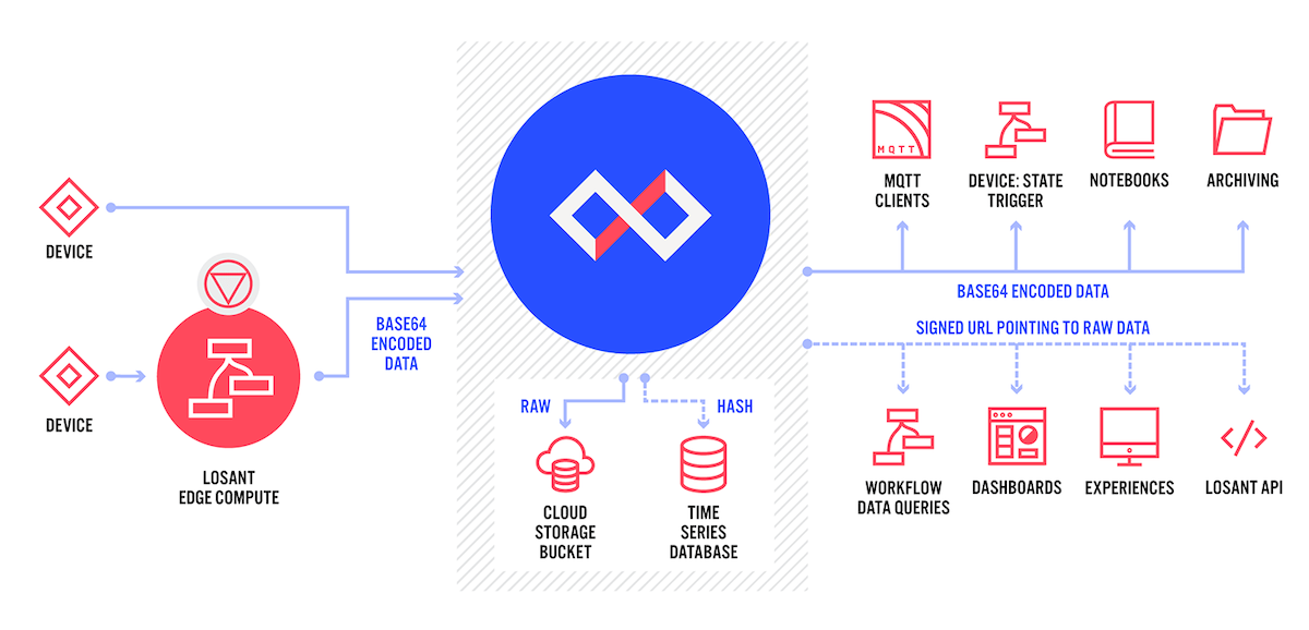

Depending on what resource you are using in Losant you can either get the original Base64 data or a Signed URL. This is because the data can be so large it can be difficult to get all the data into a payload, thus you may get back a Signed URL where you have the option to distribute or download in the browser or workflow.
Blob Attribute
Signed URLs​
A Signed URL is a URL with a signature and an expiration date. It allows anyone who has a copy of the link to access the data until the URL expires.

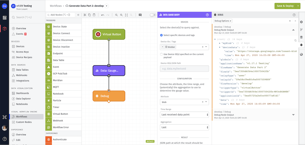

The following is an example Signed URL payload of a device state from the Data Gauge Query:
Signed Links
"data" : {
"result": {
"value": "https://storage.googleapis.com/losant-blob/5ea05725a2efcc00077a81d1/5ea057fc848d990006aceae9/blob/1588017908000-44221a392685cefc91513cfbdea1fbd8.jpeg?GoogleAccessId=data-export%40structure-1104.iam.gserviceaccount.com&Expires=1588104310&Signature=X%2FiIWMGwykuqmG9d57Kb%2Fz8s%2BFvnH4Xuq58%2BR2ekrC5CpBIWhrUYOBK4LrUjDuBNGn2IdsuhcKKJ4iPAO3PCEaj6avmwbn9TsePkwhhmmJiJeYHbe3IGMG3XdQUDauffIqUtaOpjP7oE8ddXAhJNm%2F43ekDIsiiqJOSt%2F3Fc94GBeAMaich6w40w%2FrAWlP6rlkAODQQxOftU8JmZesV65sR3g4hClfYntodFpAF9Ks4sCpjorhH2M79ceTVvnf4DtS00zzpII7iBKmbYU4d7fxqoUwlPqOApmnftaLoYgL%2Fnkp8dkKYq%2FDmEVfmg0uYw%3D%3D&response-content-disposition=attachment%3B%20filename%3D%221588017908000-44221a392685cefc91513cfbdea1fbd8.jpeg%22",
"time": <Timestamp of the reported state>
For a Data Gauge Query, you get a Signed URL because the data has already been saved and you can download the file using the HTTP node on the workflow.

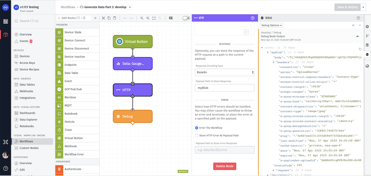

Downloading within a Workflow​
Downloading the Blob Data from a Signed URL within a workflow can be accomplished with the HTTP Node.
Downloading Blob Data
The most important field to set is the "Response Encoding Type" to Base64. Then the Blob Data will be within the body of the response.

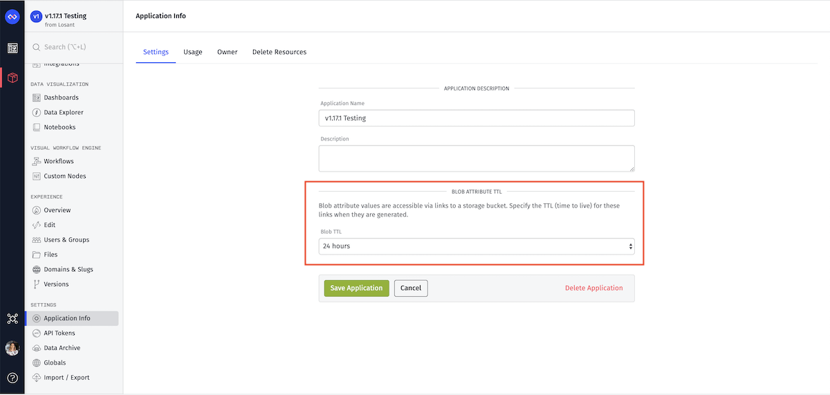

Signed URLs don't last forever. The time to live for the Signed URL is configurable on an application level.
Blob TTL
To update the Blob Attribute TTL:
  1. From the Application Menu, navigate to the "Application Info" page.
  2. Select "Blob Attribute TTL".
The maximum time a Signed URL can live is a week and the shortest is an hour. The default for each application is 24 hours.

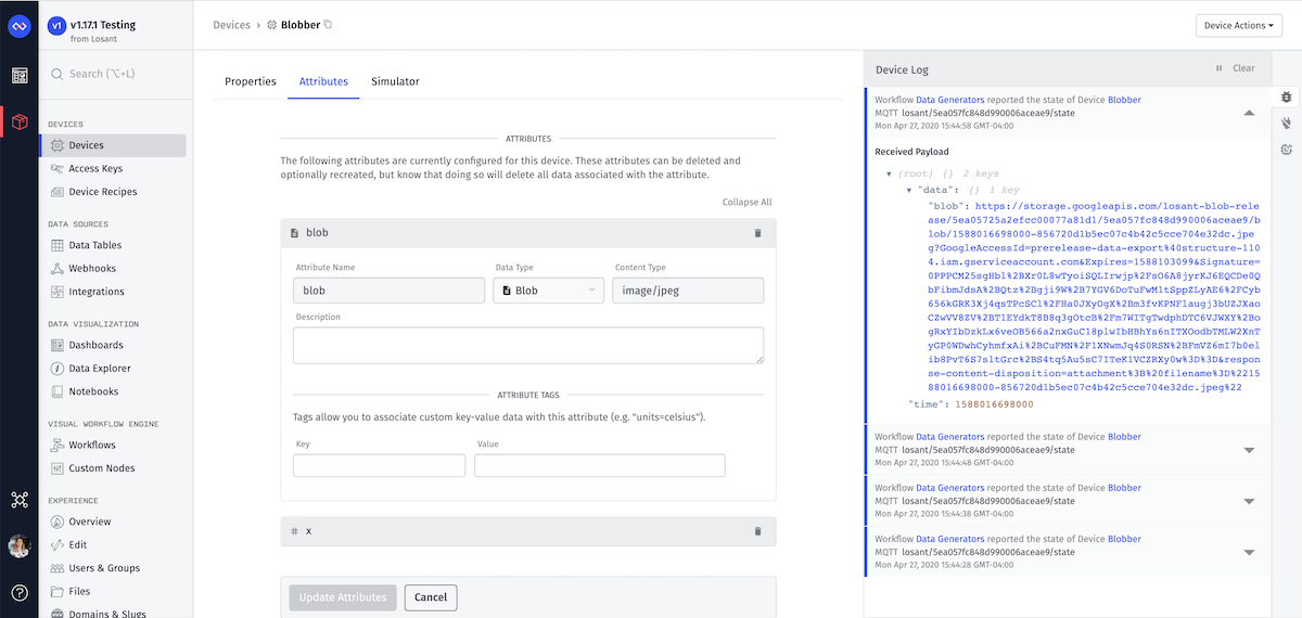

Blob attributes are reported the same way as other device attribute types. However, Blobs must be reported as Base64 encoded values.
Content Types​
When configuring a Blob attribute, you must provide a Content Type, which defines the file type of the Blob Data. This also ensure the proper file extension on the Signed URL.
