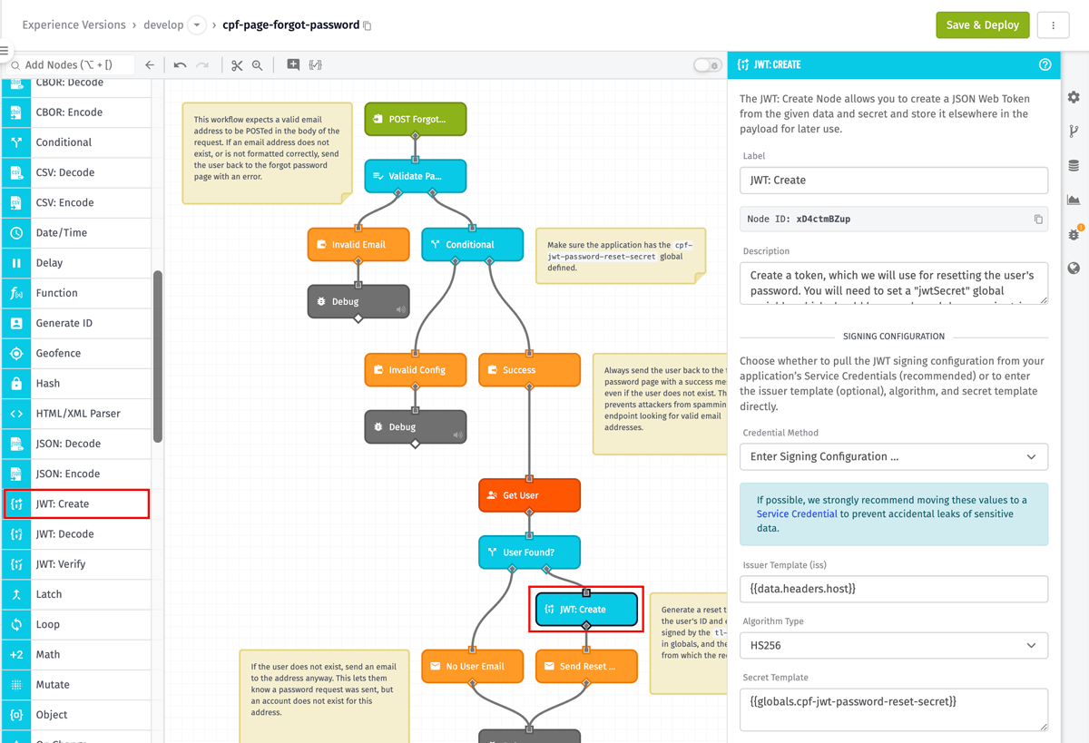

Signing Configuration​
Choose whether to pull the JWT signing configuration from your application’s Service Credentials (recommended) or to enter the values directly.
Choose a Service Credential​
The issuer, algorithm, and secret are provided by the selected JWT Service Credential. This is the recommended option. This option is not available for Edge Workflows.
Enter Signing Configuration​
  • Issuer Template: (optional) The string template specifying the issuer of the token. This is most commonly your company's domain (e.g. example.com), however it can be any string.
  • Algorithm Type: The algorithm that is used to generate the JWT signature. The default value is "HS256", and in most cases this does not need to be changed. If you provide an alg value as a custom header, the value of the header will override the value selected here. This allows for templating the algorithm if necessary.
  • Secret Template: The secret that's incorporated into the JWT signature. In most cases, this should be a string template referencing a value that can be retrieved later (for example, a value stored in a workflow global) so that the token can be verified later using a JWT: Verify Node. This value should be similar to a strong password and should never be shared.

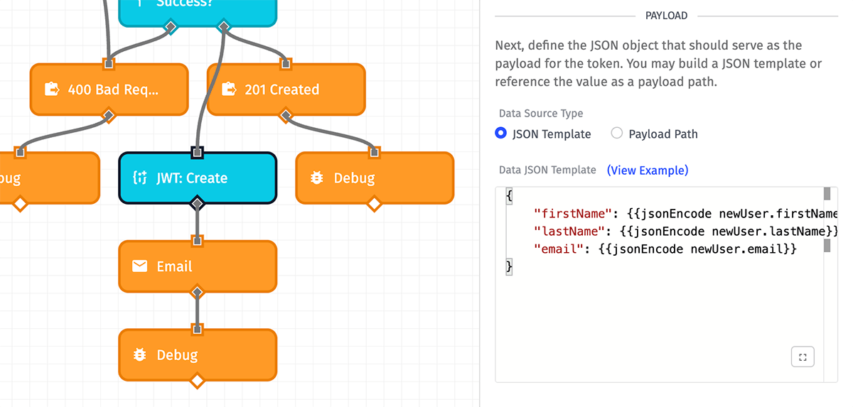

Payload​
Next, define a JSON object to serve as the payload for the JWT. The object can be defined one of two ways:
JWT: Create Node Payload
  • JSON Template: When selected, you must define the properties and values of the token's payload as a JSON template.
  • Payload Path: When selected, you must enter a payload path to an object on your workflow's payload to serve as the payload of the JWT.
Note: Losant automatically adds an iat (Issued At) value to the payload, which is a Unix timestamp (in seconds) at which the token was created. You may add your own iat value to override this.

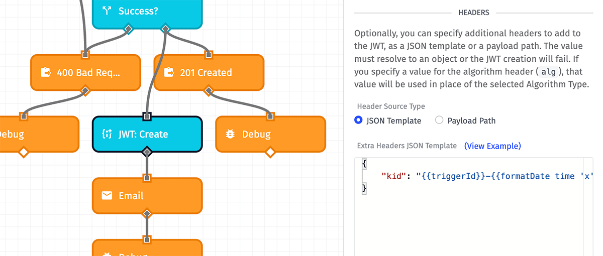

Headers​
Optionally, you may also specify a JSON object to add custom headers to your JSON Web Token. This is useful for adding other universally accepted properties to the token, such as kid (Key Identifier).
As with the token's payload, you may define the custom headers one of two ways:
JWT: Create Node Headers
  • JSON Template: When selected, you may define the properties and values of the header as a JSON template.
  • Payload Path: When selected, you may enter a payload path to an object on your workflow's payload containing the header values you would like to append to the JWT.
Note: For Edge Workflows, this setting is only available in GEA version 1.31.0 or higher.

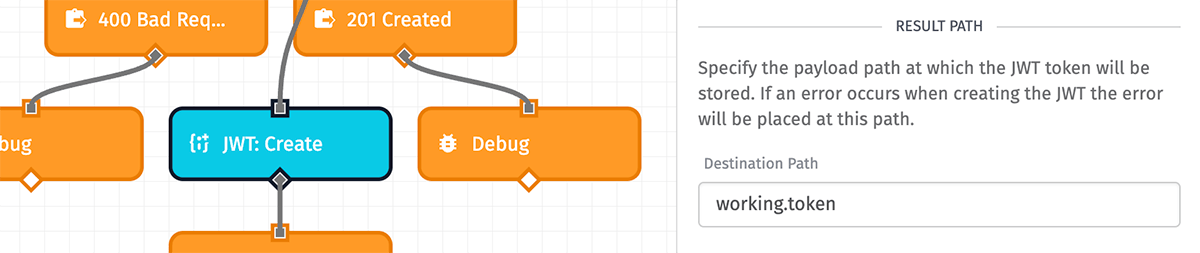

Destination Path​
Finally, enter a payload path for where to place the signed JWT on your workflow payload. The result will be the JWT (as a string) or, if an error occurs, an error object with additional information about the exception.
