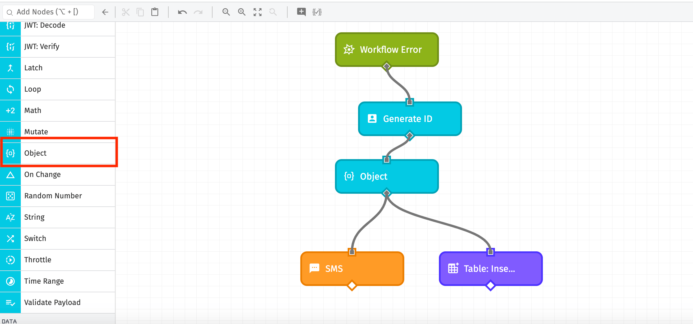

Object Node
The Object Node allows a workflow to perform operations against an Object or Array on the payload.
Object Node
