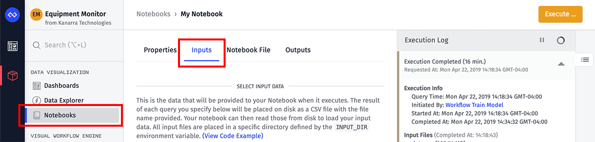

The inputs tab of your notebook configuration allows you to generate datasets from your devices and data tables. Those datasets can then be used within your notebook file to find deeper insights into your IoT application.
To edit a notebook's input datasets, click the "Inputs" tab after navigating to one of your application's notebooks. Note: Upon first creating a notebook, this is also the tab to which you will be redirected as configuring inputs is often the next step in the notebook creation process.

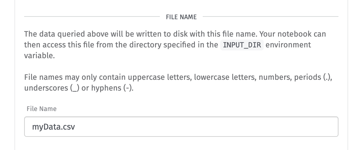

File Names
In addition to the extra configuration options for each input type as outlined below, each input also requires a File Name, which is the name of the file as it will be written to disk with the contents of the input's dataset. These names either must be templates or ...
- Must be unique across all inputs for the notebook
- May only contain uppercase letters, lowercase letters, numbers, periods (.), underscores (_) or hyphens (-)
- Should (but are not required to) match the file extension of the input

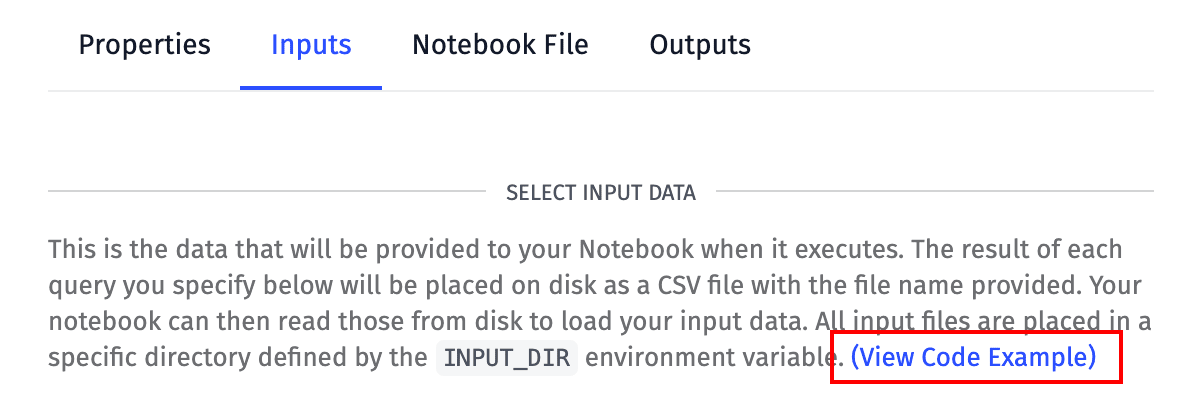

You may view a Python code example matching your current notebook configuration by clicking the "View Code Example" link at the top of the Notebook Inputs page.

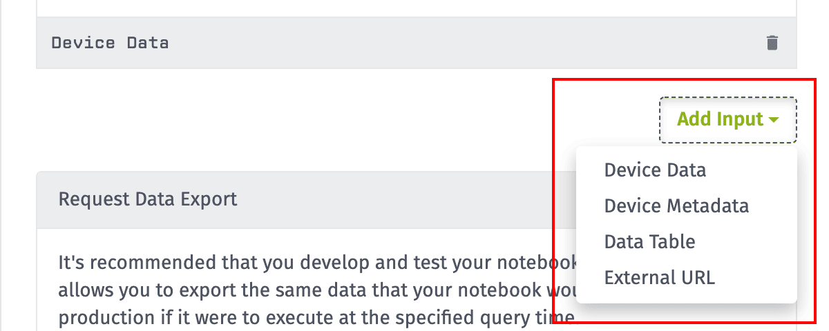

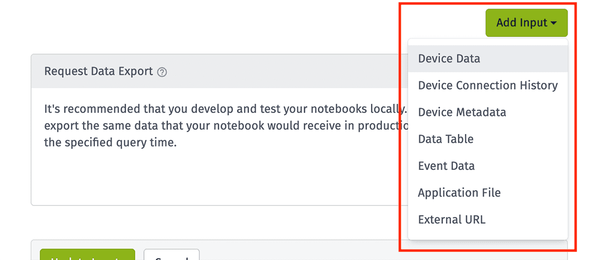

To add a dataset to your notebook, click the "Add Input" dropdown and choose the type of input you would like to add. There are four different types of data you can use within a notebook ...

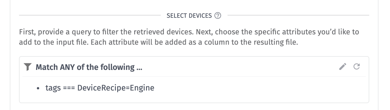

Selecting Device Data Devices
First, enter a device query for all the devices whose data you need. The data for any device that matches the given query will be available in your input data.
Selecting Attributes
By default, your input dataset will include all attribute data from all devices returned in your device query. However, you may choose to return only data from a specific set of attributes. If choosing this option, you must select at least one attribute for which to return data.

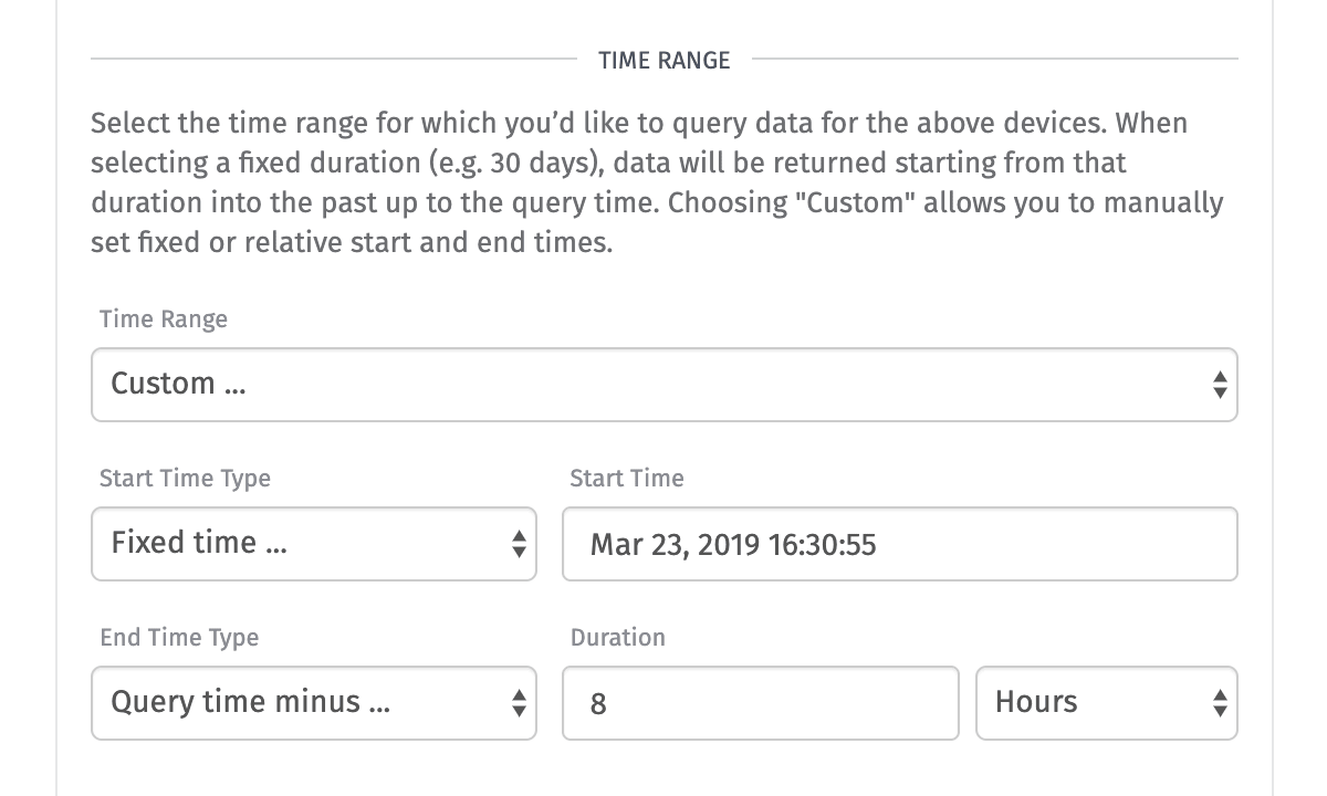

Time Range
Generating this dataset requires defining a time range for the data to include in the input file. For most use cases, you will want to return a fixed duration that falls on a natural time breakpoint (such as 60 minutes, 24 hours or 30 days). You may choose one of these predefined options for quickly building such a dataset from the "Time Range" dropdown menu.
In some cases, you may need a more specific time range, in which case you may choose the "Custom" option. Doing so will present you with a series of inputs for defining your time range's start and end time. Each end of the range can be defined one of two ways:
- Fixed time: This allows for using a specific date and time in the past at which to start or end your dataset. This can be useful for analyzing how your application is evolving over its entire lifetime. Note: Data returned using a fixed start time is still subject to your account's data retention limits, and as that start time falls behind the limit, you will need to adjust this value.
- Query time minus: This allows for defining times that are relative - in a number of days, hours, minutes or seconds - before the notebook execution's query time. This can be useful for week-over-week comparisons and the like.

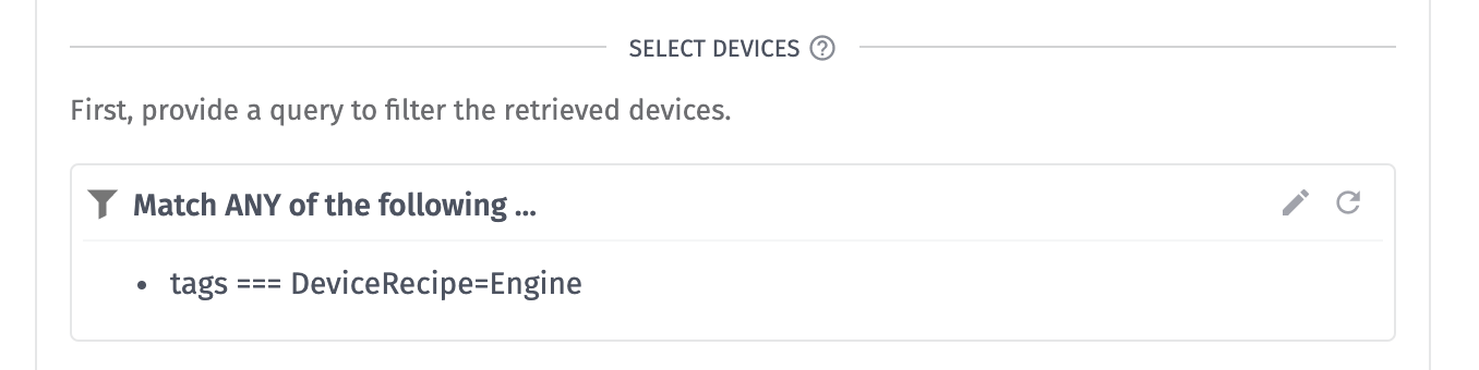

Selecting Device Metadata Devices
Selecting devices here behaves the same way as it does for selecting devices in the device data input type.

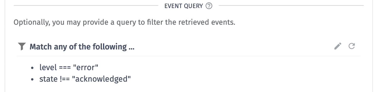

Event Query
You may filter the returned event data by providing an event query.

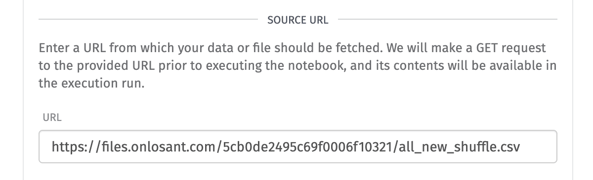

You may also include data from an external URL as a dataset within your notebook. The source can come from any public address.
Source URL
Enter the URL of where to retrieve the data source here. The source must be available via a GET request over the HTTP or HTTPS protocols (as in, it may not come from an FTP address).

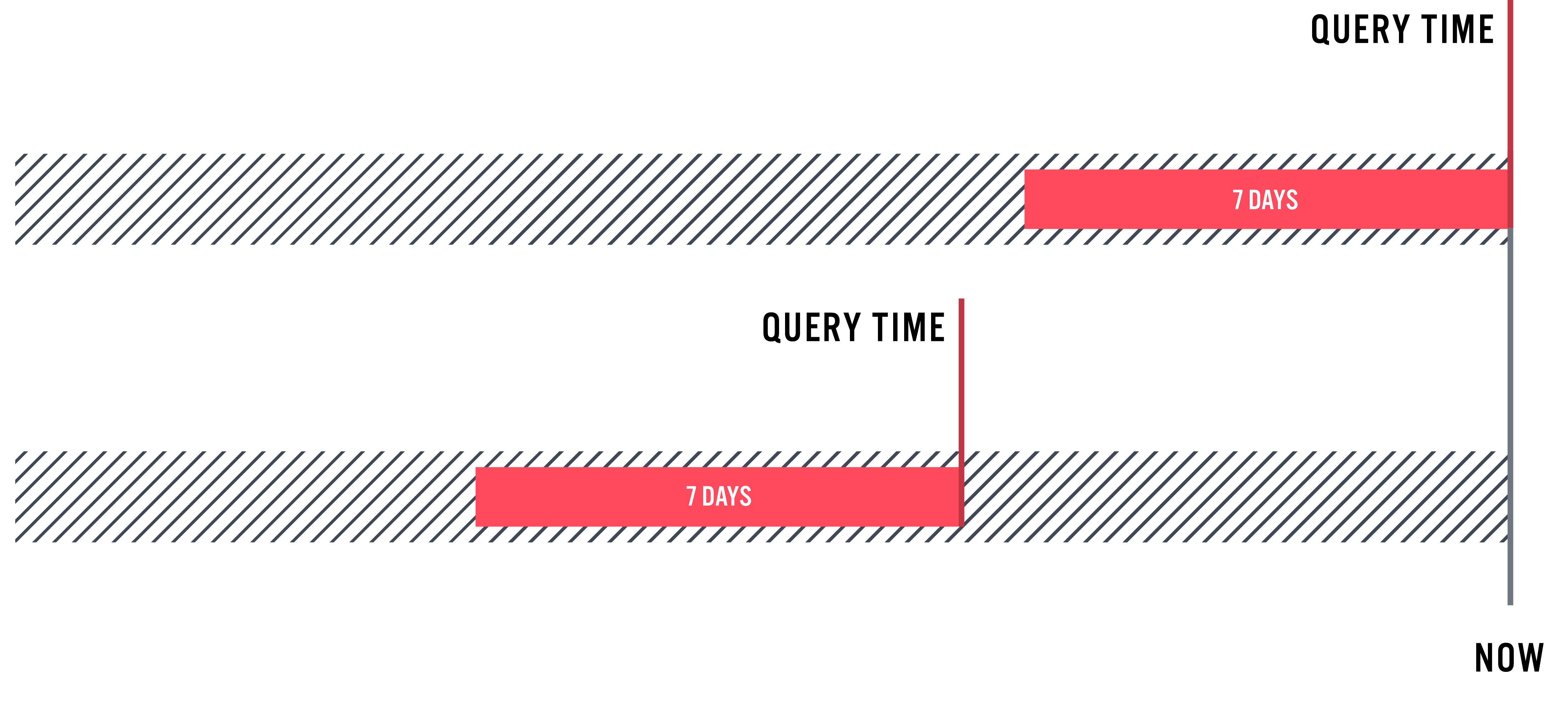

Query Times
When requesting a data export or executing your notebook, you must pass a "Query Time" to use for that action. This serves as the anchor point against which any device data datasets are built.
You must also set a query time when executing a notebook via the Notebook: Execute Node, though in that case you may default the value to the time of the workflow payload.
Query Time Example
For example, let's say we set a query time of "Apr 10, 2019 12:00:00". Given the custom time range defined in the device data example above ...
- Start time is the fixed time of "Mar 23, 2019 16:30:55"
- End time is the query time minus 8 hours
Our device data dataset will return all state reports for the given devices and attributes that occurred between Mar 23, 2019 16:30:55 and Apr 10, 2019 04:00:00.
Requesting another execution with a query time of "May 1, 2019 06:00:00" will return state reports between Mar 23, 2019 16:30:55 and Apr 30, 2019 22:00:00.

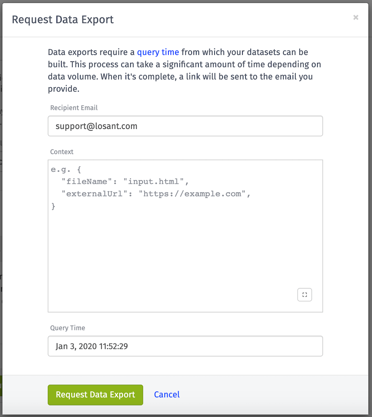

Requesting Data Exports
After you have configured all of your notebook's inputs, you may request a sample export of all datasets. This is useful for developing your Jupyter notebook locally and testing out your code before rolling your notebook out for production use.
Click the "Request Data Export ..." button at the bottom of the "Inputs" tab. This will display a modal asking for an email address, context object, and a query time for the sample data.
Soon after submitting, you will receive an email with links for where to download each of your datasets. Generating the sample data can take anywhere from a couple seconds to several minutes, depending on the size of the datasets in each of the inputs.
