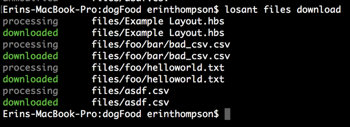

The download command is used to download your files and to resolve conflicts between your local files and your Application's (remote) files. To start a download run losant files download.

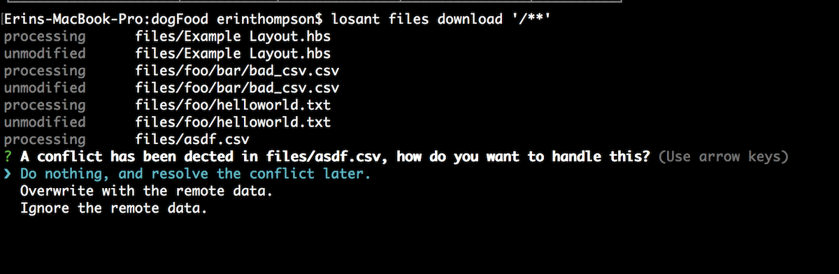

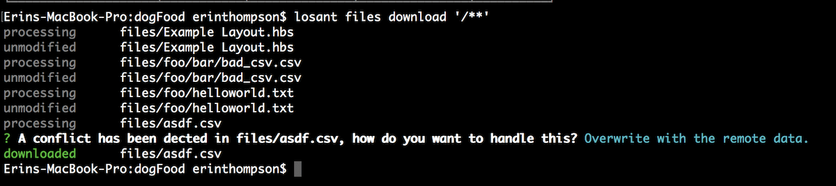

If you have conflicts (which can be seen when running losant files status) when you try to download you can resolve your conflicts. When a conflict is detected for a file you will be prompted to choose one of three options. They are the following:
  • Do nothing, and resolve the conflict later. - resolve the conflicts yourself meaning you will update both the remote and your local copy to get back into a non-conflicting state.
  • Overwrite with the remote data. - use the data from the remote files
  • Pull remote data, and apply my local changes. - this will download remote data but keep any file that has changes the same.

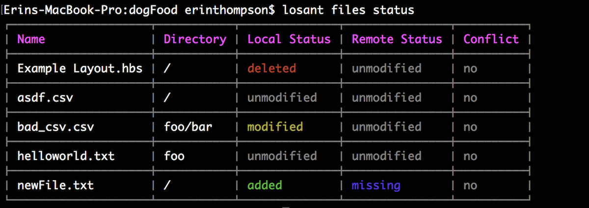

The status command prints a table for each files indicating the status locally, remotely and whether they are conflicting. This command will tell you if you have added files locally, or you need to download new files from your Application, or any modifications have been made to a view either locally or remotely.
