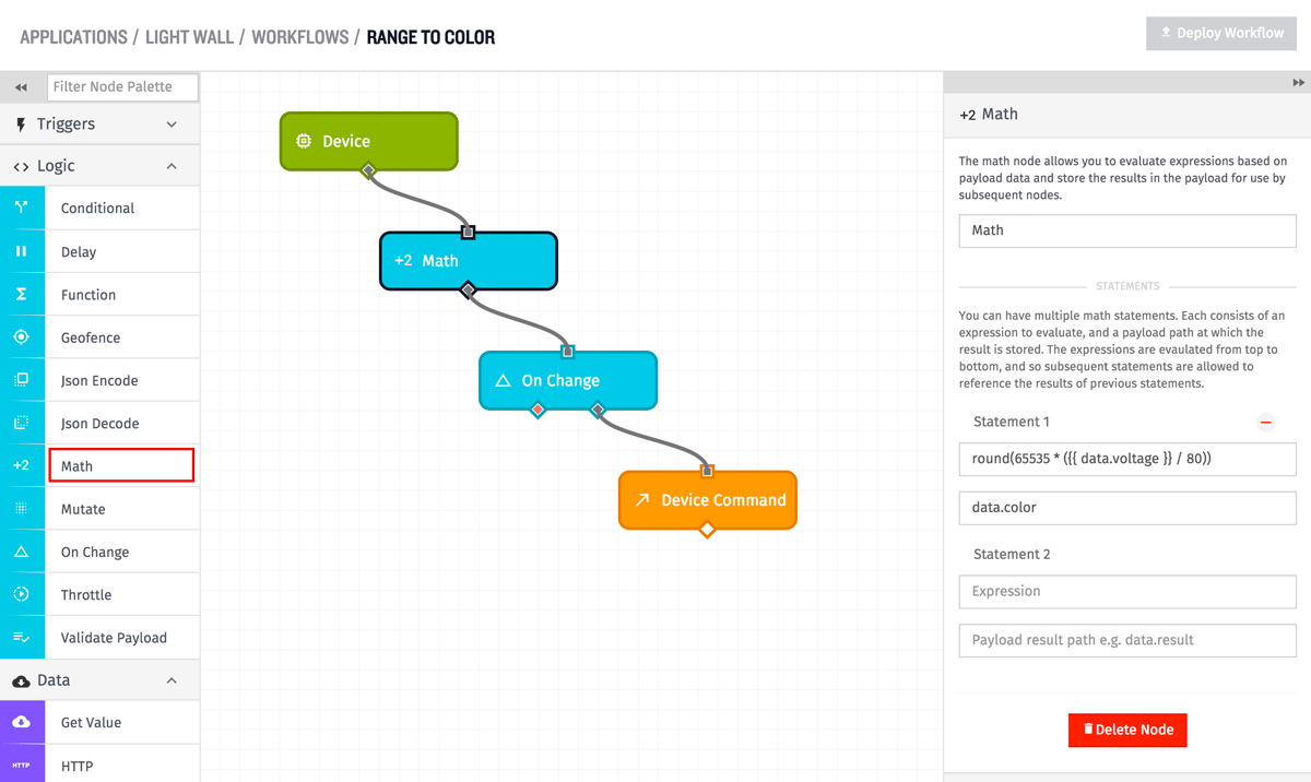

The Math Node allows a workflow to perform an arbitrary number of calculations and store their results in the payload.
Math Node

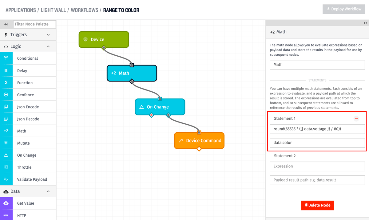

Math Nodes are configured by creating “statements”, and each statement has two values to configure. First is the expression, which is what is actually evaluated. Second is the result path, which is a payload path describing where on the payload the result from evaluating the expression should be stored. A Math Node can have an arbitrary number of these “statements”, and they are executed in order from first to last - which means that subsequent statements can use the results of previous statements if desired.
Math Node Config
In the above example, the workflow will take the value in the data.voltage field of the payload, divide it by 80, multiple it by 65535, and store the resulting value in the data.color field of the payload. So, for example, given the payload:
    "voltage": 1.7
The payload after execution of the Math Node would look like:
    "voltage": 1.7,
    "color": 1393
