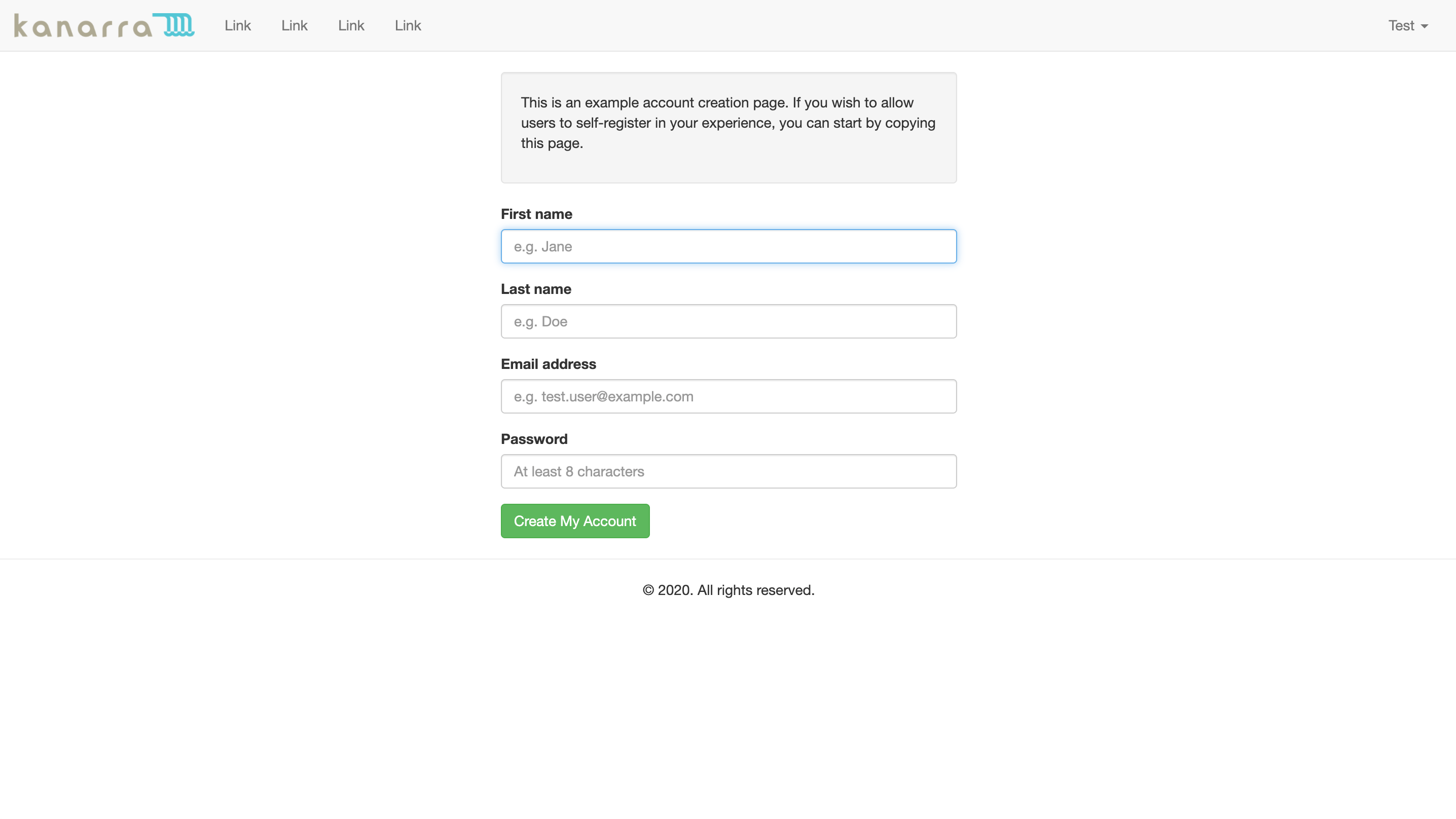

Page: Create Account
First, create a new page to render when this endpoint is requested:
- Click the "Add" button in the "Pages" list.
Namethe pageCreate Account.- Add an optional description.
- Select your previously created layout for the page's
Layout. - Click "Create Page". This will redirect you to a screen where you can edit the new page's content.
- Copy this snippet and paste it in for the page's
Content. - Click "Create Page" to save your work.
Component: profileForm
There's a component in your Create Account page that serves as the form for collecting new user data. To create the component:
- From the Experience Views list, click the "Add" button in the "Components" list.
Namethe componentprofileForm.- Copy this snippet and paste it for the component's
Content.

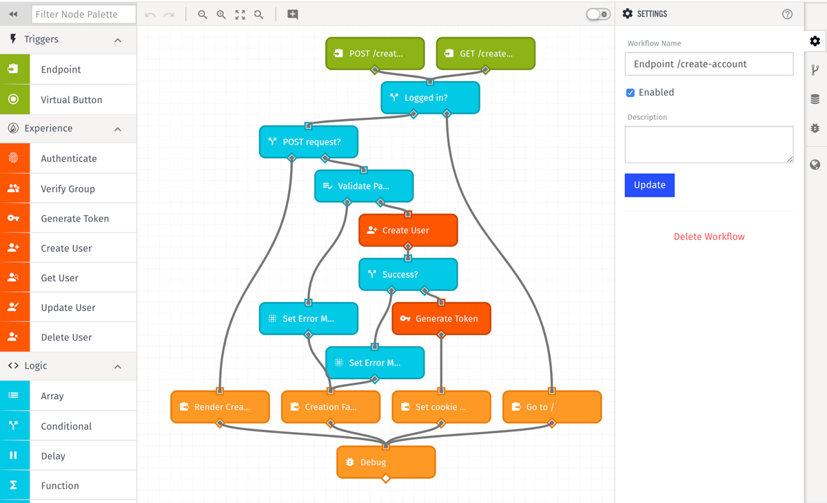

Now, similar to your login page, create a single workflow for handling both GET and POST requests to your /create-account route.
- Download the workflow template, then import the file
endpoint-create-account.flowas a new experience workflow. - Update each of the endpoint triggers to point to the
POST /create-accountandGET /create-accountendpoints you created above. - Update the endpoint reply nodes to point to your
Create Accountpage. - Enable the workflow (since imported workflows are by default disabled).
As a general overview, this workflow handles the following:
- If a user visits
/create-account, you respond to the request with our newCreate Accountpage, unless the user is already logged in, in which case they are redirected to our experience Home page. - When that user submits the
Create Accountform, you validate that they have submitted all fields correctly. Then, you check to make sure you do not already have an experience user with the same email address already tied to the application. If either of these checks fail, the re-render theCreate Accountpage with an error message. - If account creation is successful, you generate an auth token, set it as a cookie and redirect the user to our experience home page.
There is a comment on each workflow node describing its function in more detail.

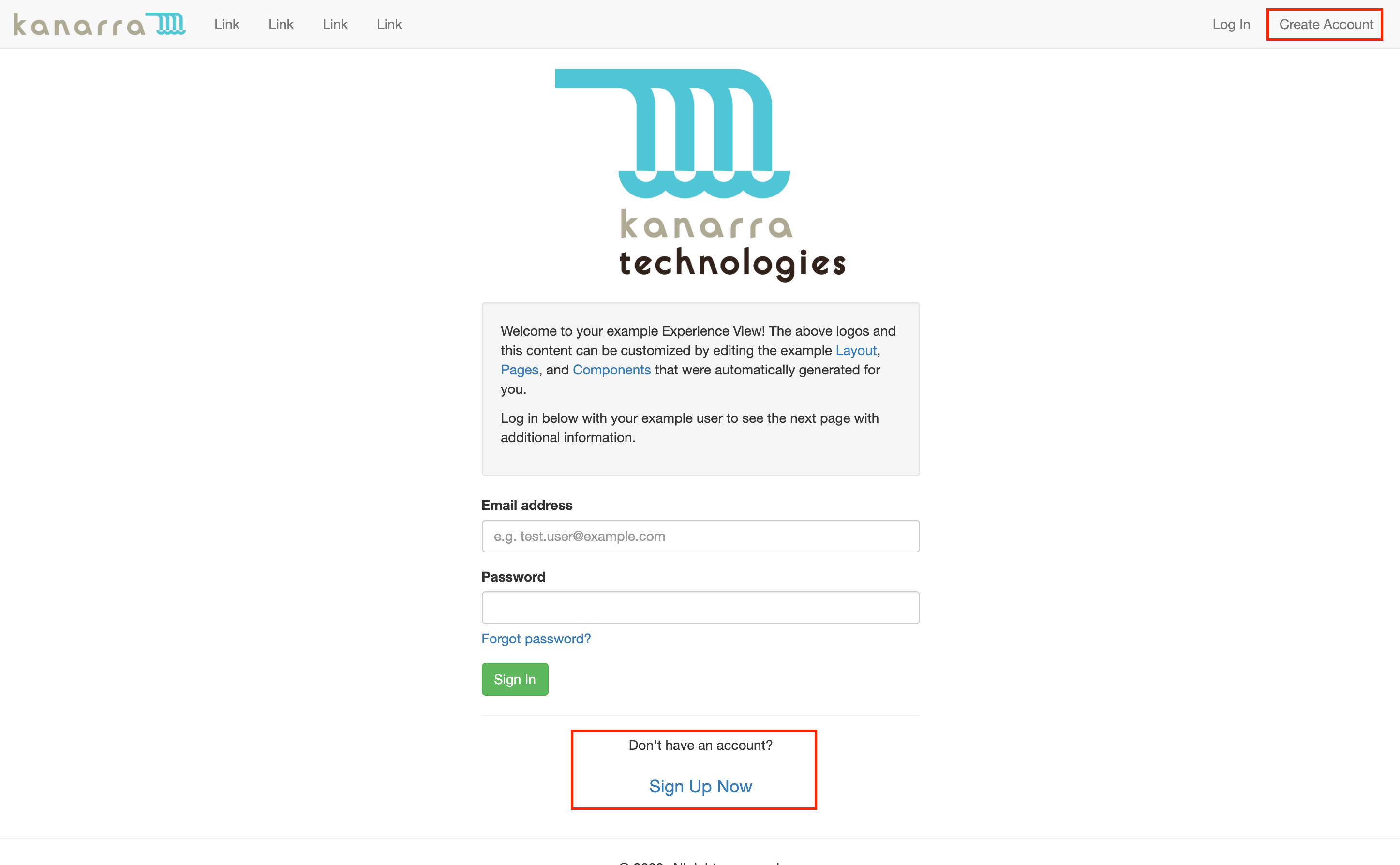

Page Edits: Log In
First, edit your "Log In" page to add a section that will serve as a lead-in to account creation. Copy the following and use it to overwrite our current "Log In" page content:
You've added these few lines just above the closing </form> tag. This renders the call to action below your submit button.
Component Edits: userIndicator
Also update our site navigation to include a link to the account creation page, but only when the user is not signed in. To do that, add a line to your "userIndicator" component. Add the following line immediately after our "Log In" link:
Alternatively, you can copy the full component and paste it as the new content of userIndicator.
