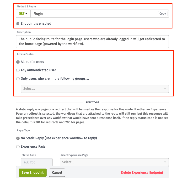

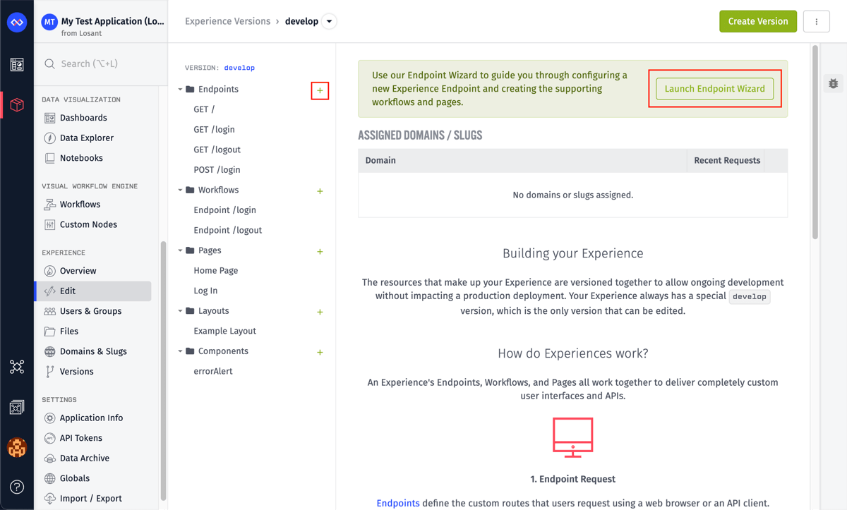

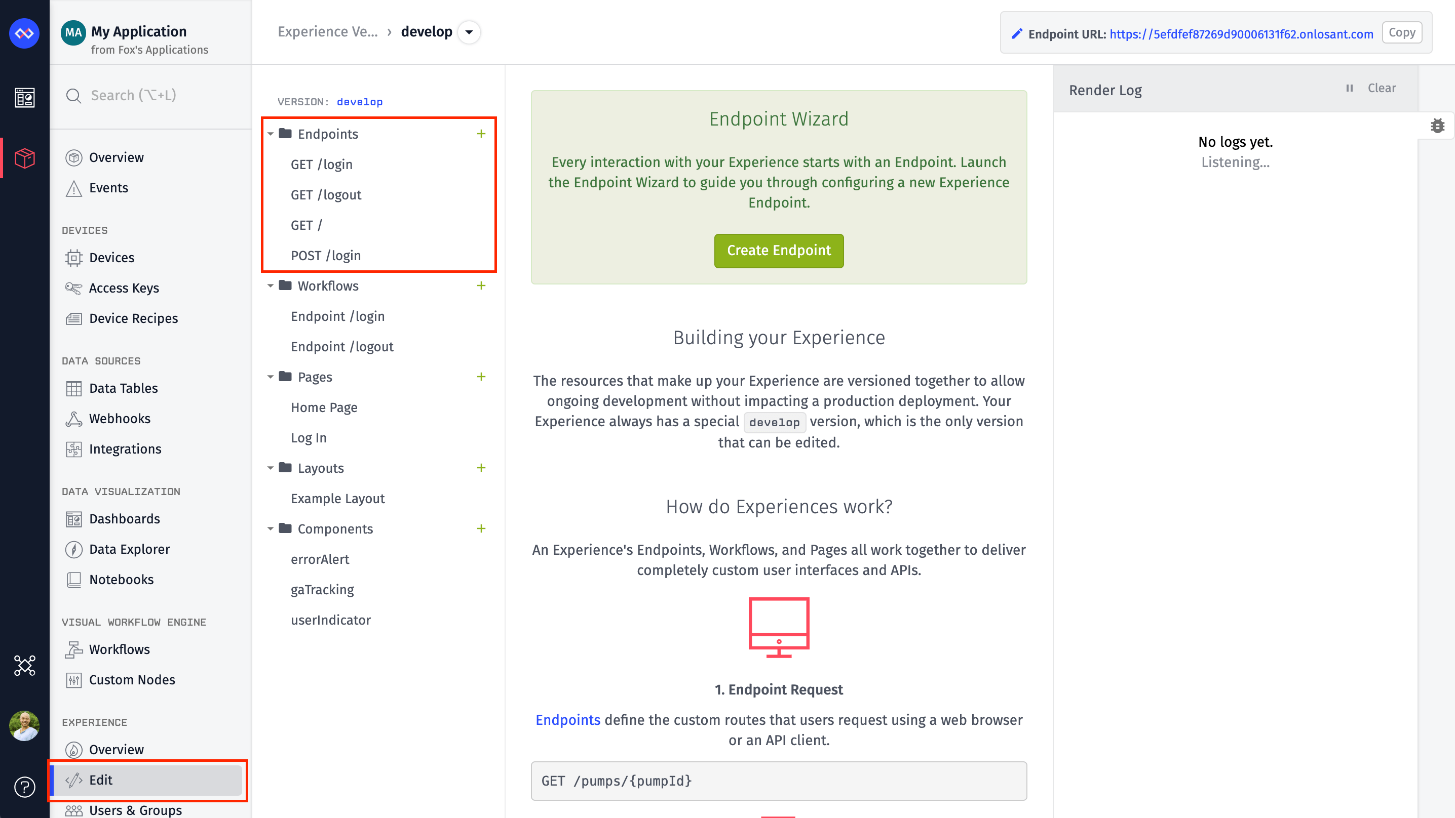

Define two endpoints that allow users to log in to your experience. The first, GET /login, returns the form with the email and password fields. The second, POST /login, accepts the credentials from the form, authenticates the user, and sets a cookie in their browser for future requests.
You can define endpoints under "Endpoints".
Losant provides an Endpoint Wizard to create and configure your new endpoint as well as any new pages or workflows necessary to utilize it:
The purpose of this guide is to walk through all of the steps. The instructions to follow assume that you select 'Custom':
- Click the "Add" button on the top right of the endpoints list to add the new
GET /loginendpoint.
- Set the
MethodtoGET. - Set the
Routeto/login. - Change
Access ControltoAll public users.
Access control defines who is allowed to request this endpoint. Since this is the login route, this needs to be set to All public users because no one is logged in yet.
- Click the "Save Endpoint" button to create this endpoint.
Repeat the same process again for the POST /login route, but set the Method to POST. At this point you will have two endpoints defined.

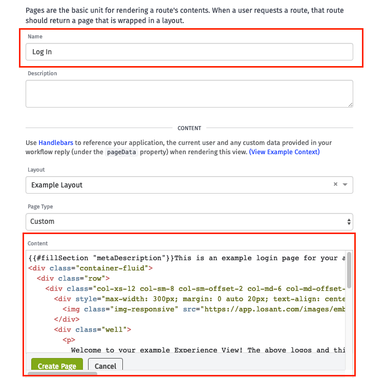

By themselves, endpoints have no functionality until a workflow is triggered. The workflow that powers these two endpoints returns the login page. For that to happen, you must first create the page.
Pages work similarly to the layouts and components you've already seen. Each one requires a name and content. Unlike layouts and components, however, pages also accept a layout. When this page is requested, this is the layout that it will be rendered into.
The content for this example is here:
Most of the content in this page is Twitter Bootstrap markup.
fillSection Helper
The first line on this example page uses a special fillSection Handlebar helper to replace the description tag in the layout's header.
{{#fillSection "metaDescription"}}This is an example login page for your
application experience.{{/fillSection}}
Sections allow you to define areas within a layout that your pages can replace. This example uses a section to allow pages to override the description meta tag in the layout's header.

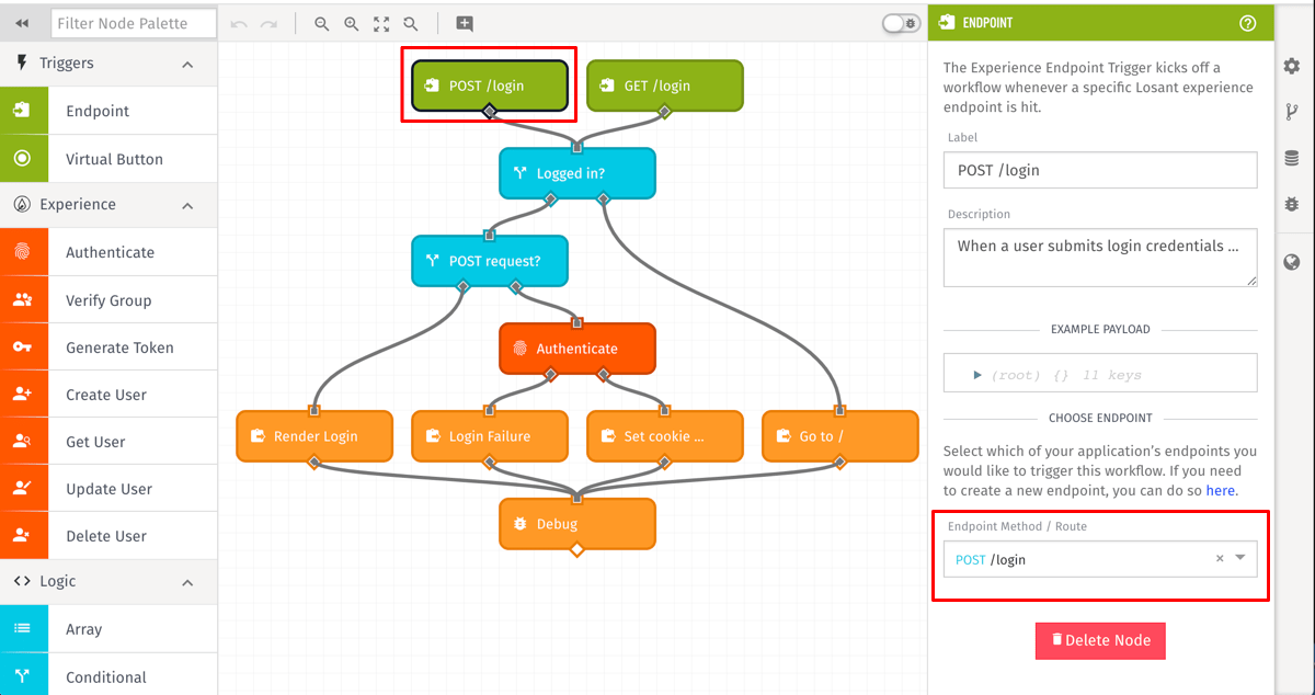

- Click the two endpoint triggers at the top and set the
Endpoint Method / Routeto the corresponding endpoints you created earlier.

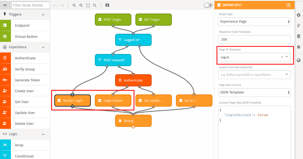

- Edit the two Endpoint Reply nodes and set the
Page Templatefield to your newly created Log In page.

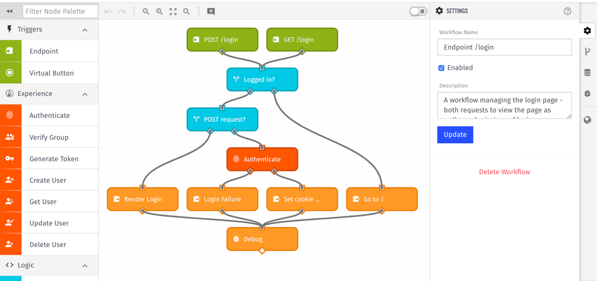

This workflow triggers for both the GET /login and POST /login endpoints. Once triggered, this workflow does the following tasks:
- Checks to see if a user is already logged in. If a user is logged in, the
experience.userpayload path will be automatically filled in with the user's details. - If a user is logged in, the workflow replies with a redirect to
/, which is the home page that's created in the next part of this walkthrough. - If the user is not logged in, the workflow then checks whether its handling the
GETorPOSTrequest. - If it's the
GETrequest, the workflow replies with the Log In page you just created. - If it's the
POSTrequest, the workflow uses the Authenticate node to check if the email and password provided by the user are valid. - If the authentication fails, the workflow replies with the Log In page again, but this time it sets the
loginFailureandemailfields. These are used to display an error to the user and prepopulate the email field so the user doesn't have to retype it. - If the authentication succeeds, the user is redirected to the home page. The reply node also sets an
authorizationcookie set to the user's authentication token, which was obtained from the previous Authentication node. The browser automatically sends this cookie with each subsequent request, so Losant can keep the user logged in during their session.

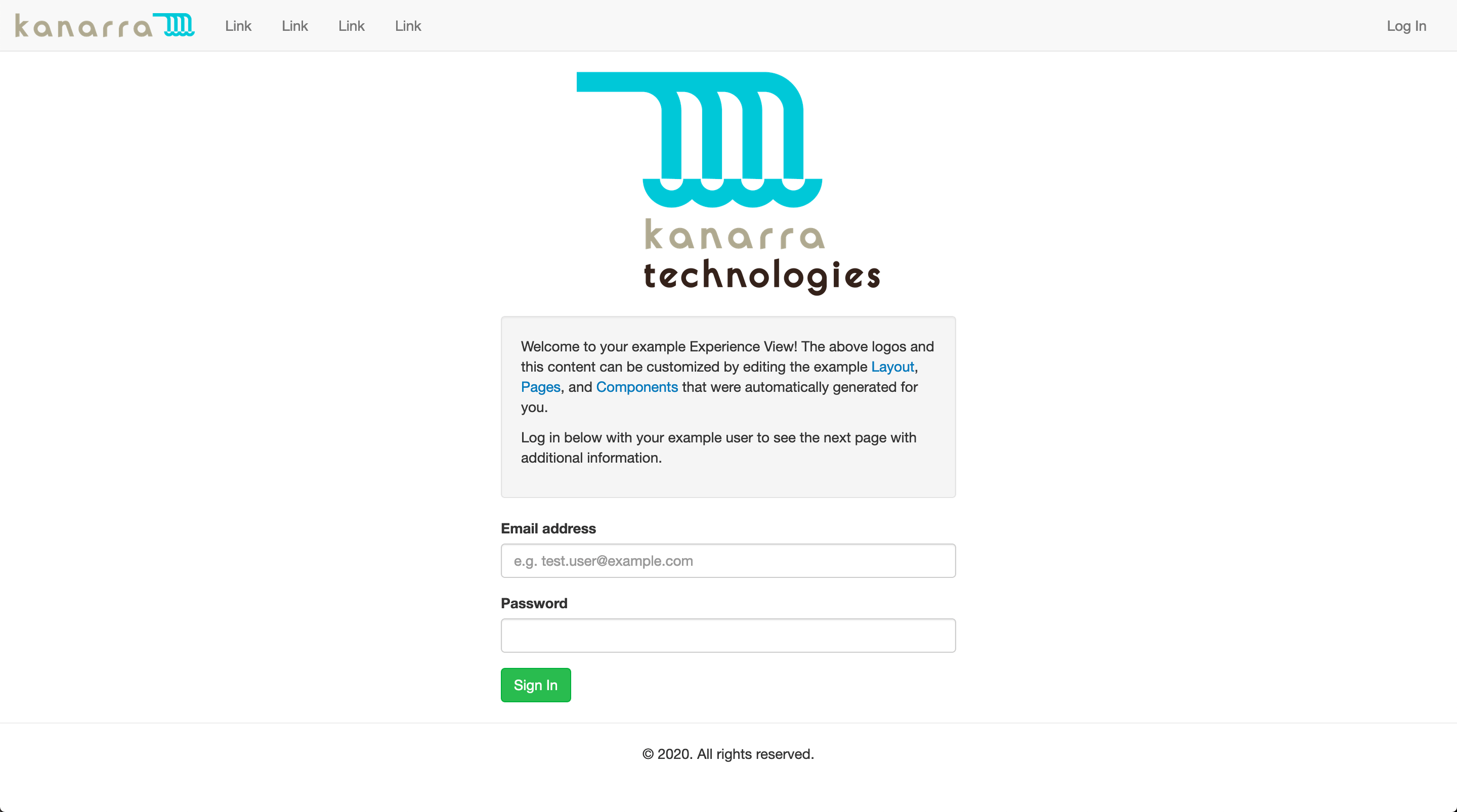

After deploying this workflow, you can now test the page by requesting your /login endpoint. If you don't already have an Experience User, create one you can log in with.
After you log in, the above workflow attempts to redirect you to /, which hasn't been defined yet. This means you'll get an error message. In the next part of this workflow, you'll create the home page that's only accessible to authenticated users.
