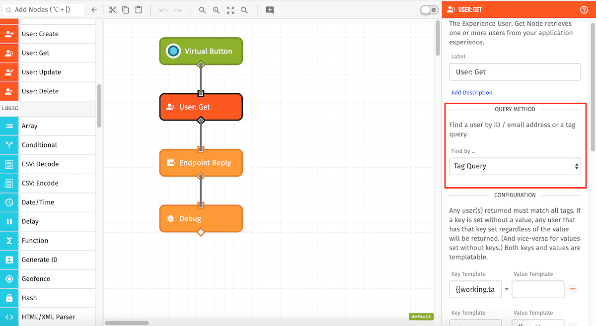

Query Method
There are three ways to query for experience users using this node, all of which support templating.
- Email/ID: Either a user's ID or a user's email. The node will automatically determine which it is based on the form of the input.
- Tag Query: Provide a set of key/value pairs to retrieve one or more users.
- Advanced Query: You can also form an advanced query to allow more complex user matching than the above methods.
Note: When providing tag queries, you may also query by key only or value only. If a key is set without a value, any user who has that key set regardless of the value will be returned. If a value is set without a key, any user who has that value set regardless of the key will be returned.

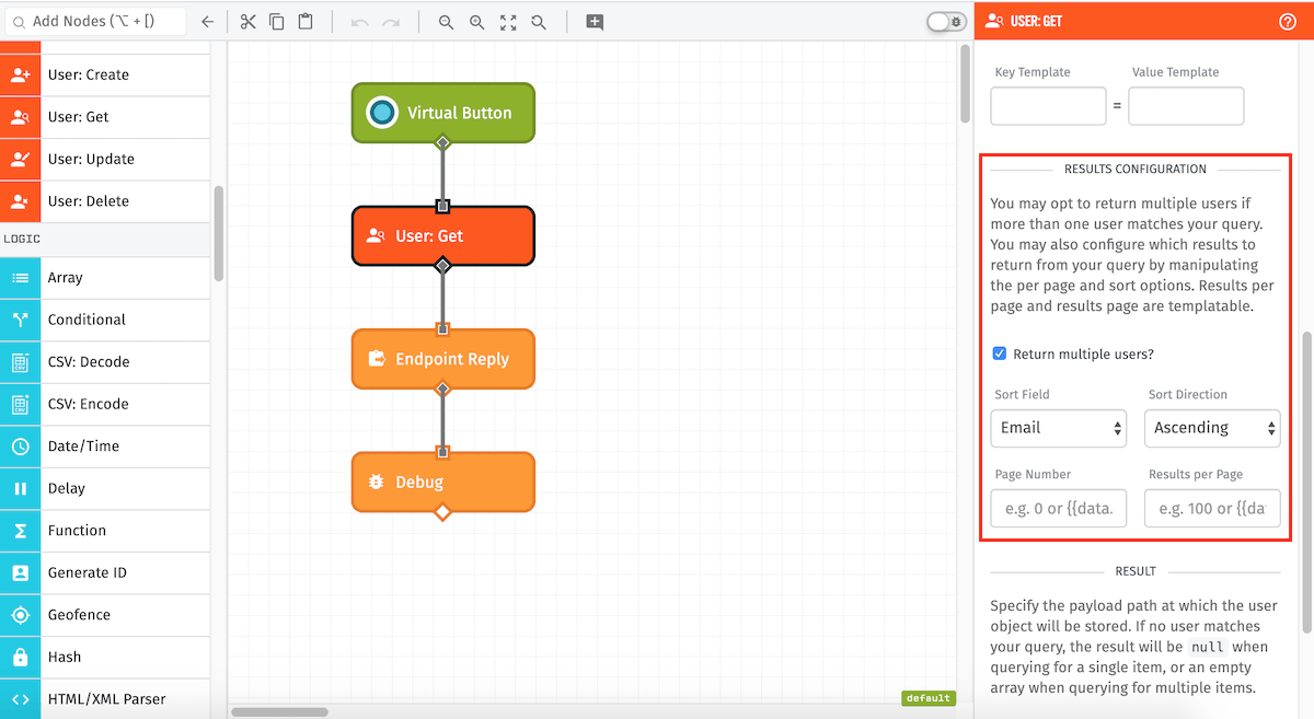

Results Configuration
If Tag Query or Advanced Query is selected as the query method, an extra set of properties will appear:
Sort Field: This is the field on the user to sort the results by. By default, this field is
email
. The following are the valid sort fields:email
,id
,firstName
,lastName
,creationDate
orlastUpdated
Sort Direction: This is the field that tells the sort field which direction to sort in. By default, this field is
asc
(ascending). -
Return multiple users?: If you want to return multiple users from this query, check this box. This also alters the return type of the result. If checked and nothing is found, an empty array will be returned instead of
null
. If checked and one or more users have been found, they will be returned as an array. If checked, the following fields also appear:- Results Per Page: This templatable input is the maximum number of users to return with one query. The max number of users that can be returned at once is 1000. The default is 100.
- Page Number: This is a templatable input that resolves to a non-negative integer. The default is 0. This defines the number of results to skip by multiplying this number by the
Results per Page
field. - Metadata: You will also have the option to return metadata in addition to the queried users.
- Return just an array of results - The User: Get Node's result will be an array of users.
- Return an object containing metadata along with results - The User: Get Node's result will be an object with keys for metadata properties in addition to an array of users in the
items
key.
Note: Even when returning a single user, sorting options affect the result.

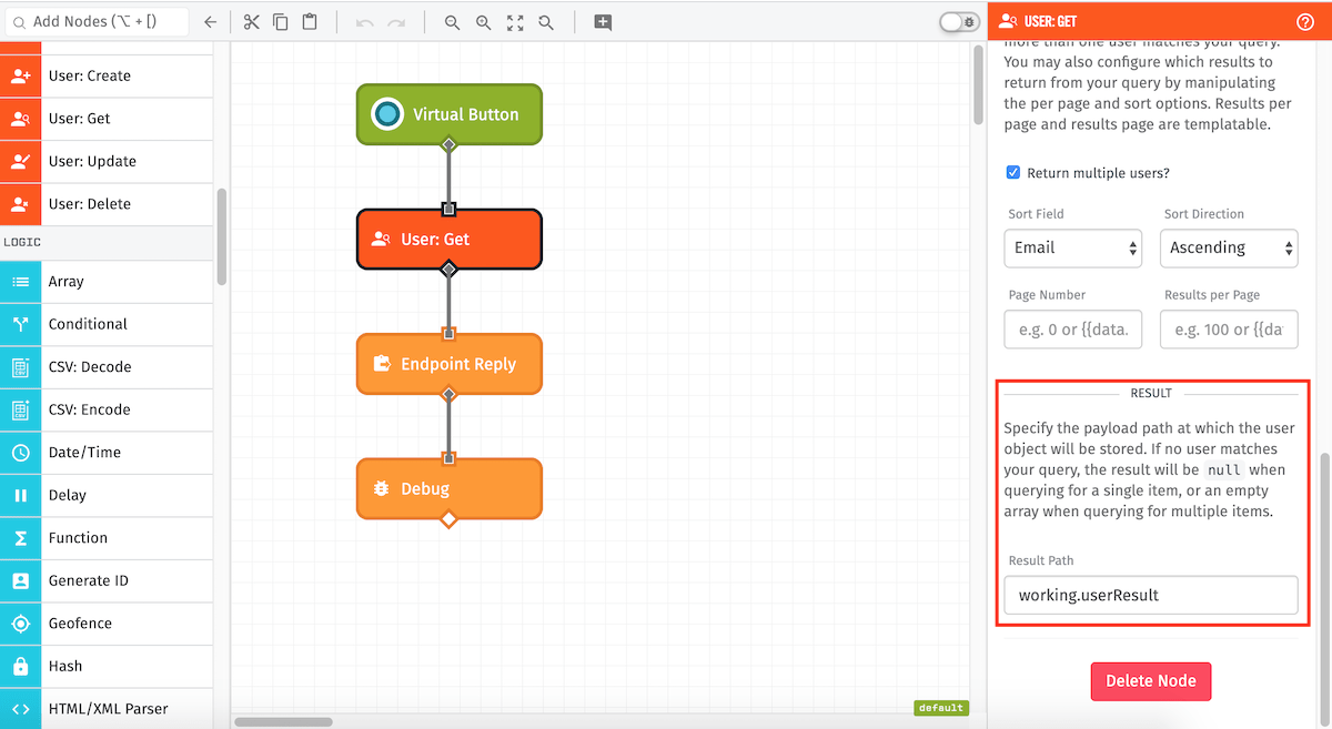

The query result will be stored at the payload path provided in the Result Path
field. If the query is configured to potentially return multiple users, this will always be an array, even if no users are found. If the query is only returning a single user (which is always the case for email/ID queries), this will either be the user object or will be null
In the example above, the workflow will retrieve any users who have the externalId
tag matching the value at data.query.systemId
on the payload, and will place the resulting users at working.userResult
