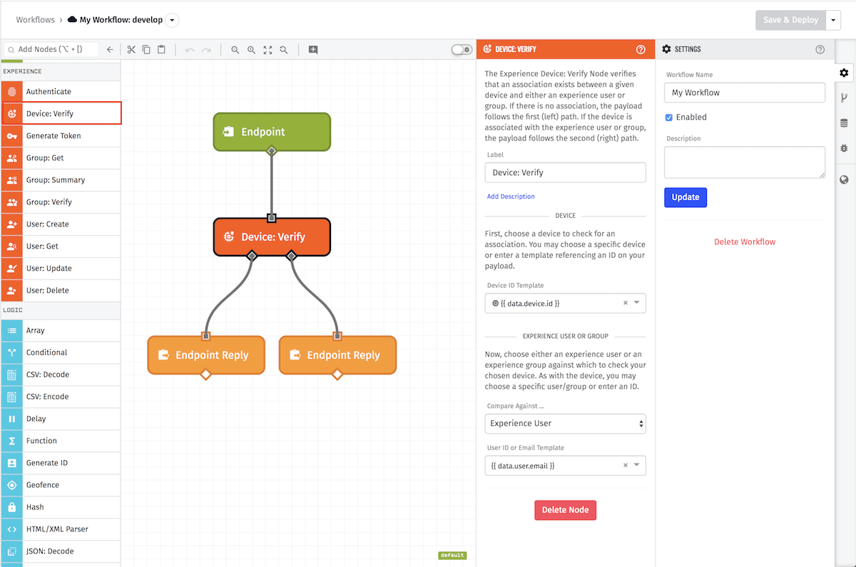

Device: Verify Node
The Device: Verify Node allows a workflow to verify that a Device is associated with an Experience Group or Experience User in the application.
The node has two required fields: a Device ID and then either an Experience User's ID or email or the Experience Group to verify the device association.
- Device ID Template: (Required) A templatable field used to identify which device to verify the association to the group or user.
- Compare Against ... (Required, Default: Experience User) Choose which type you would like to check the device association. The following are valid types:
- Experience User - When selected, you must provide User ID or Email Template, which is a templatable field that can either be an Experience User's ID or email address against which to check the device association. This defaults to
{{experience.user.id}}, which is where the ID of the authenticated user making the request is placed on the initial payload of an Endpoint Trigger. - Experience Group - When selected, you must provide Group ID Template, which is a templatable field used to identify the Experience Group to check for the device association.
There is no optional payload path to place the result, because this is a conditional node. It will either take the false (or left) or the true (or right) path depending on the result of the association.
Because this is a branching node, this node will never cause an error.
