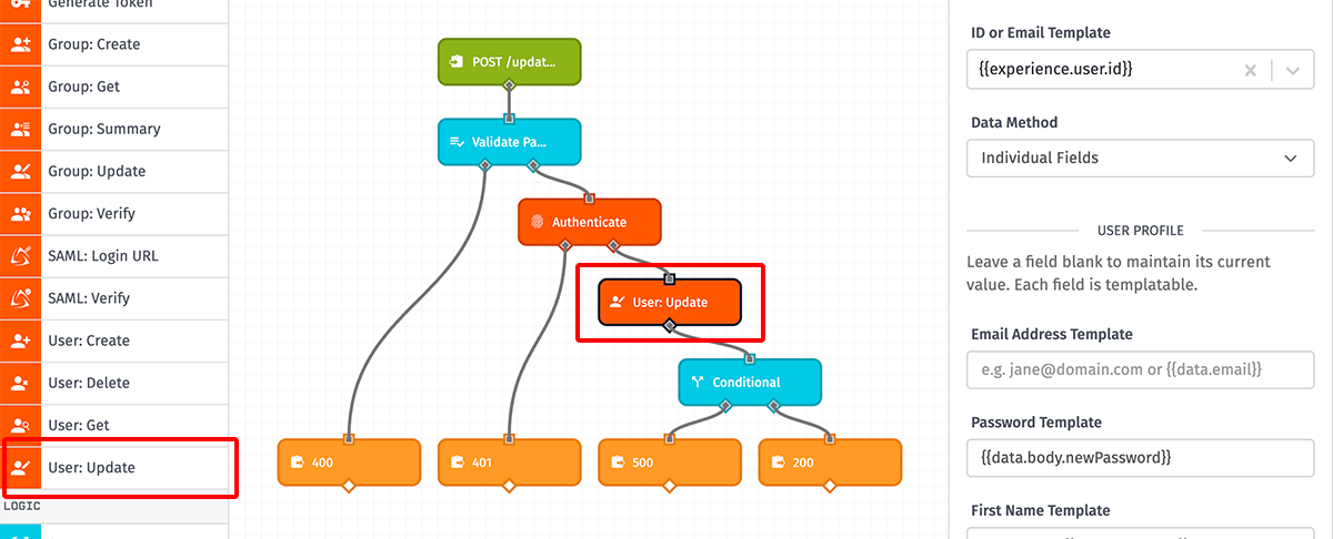

User: Update Node
The User: Update Node allows a workflow to update an existing Experience User inside the current application, and optionally add the updated user to the current workflow payload.
Configuration for the User: Update Node is broken up into several sections.
User Selection and Data Method
First, select a user to update and a method for providing the updated properties ...
- ID or Email Template: The node accepts either a user ID or email address - which are both unique within the context of the application, and so will match at most a single user. This field is templatable, and so supports finding a user based on the current workflow payload. The example above is doing exactly that, and is referencing the field
experience.user.idon the workflow payload. - Data Method: Choose one of the following options for providing updates to the user ...
- Individual Fields: When selected, user updates are broken up into additional sub-sections as described below.
- JSON Template: When selected, you must provide a User JSON Template that validates against the Experience User Patch schema.
- Payload Path: When selected, you must provide a User Payload Path that resolves to an object on the payload that validates against the Experience User Patch schema.

Given a POST request and an Endpoint Trigger execution for an Experience User attempting to change their password, with the new password in the body of the request in the newPassword field, the User: Update Node can be invoked with the following configuration ...
{{experience.user.id}} - Password Template:
{{data.body.newPassword}} - Result Path:
working.updatedUser
