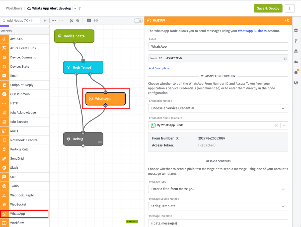

WhatsApp Node
The WhatsApp Node allows a workflow to send messages using the configured WhatsApp Business account.
There are many configuration options to provide when setting up the WhatsApp Node, broken up into several sections ...
WhatsApp Configuration
First, choose how to authenticate the request. There are two different options ...
- Choose a Service Credential: This is the recommended method; however, this method is not available in Edge Workflows. When using this method, you must provide ...
- Credential Name Template: A string template resolving to the name of one of your application's WhatsApp Service Credentials.
- Enter Configuration: When selected, you must provide ...
- From Number ID Template: A string template resolving to the ID of the From Number that the messages should be sent from. This should be the ID of a From Number associated with your WhatsApp Business account.
- Access Token Template: A string template resolving to an access token for your WhatsApp Business account, which should be rotated regularly.
Message Configuration
There are two different ways to form a WhatsApp message. The message can either be a free-form text message (message type Enter a free-form message...), or a templated message using a existing template in your WhatsApp business account (message type Choose a message template...).
