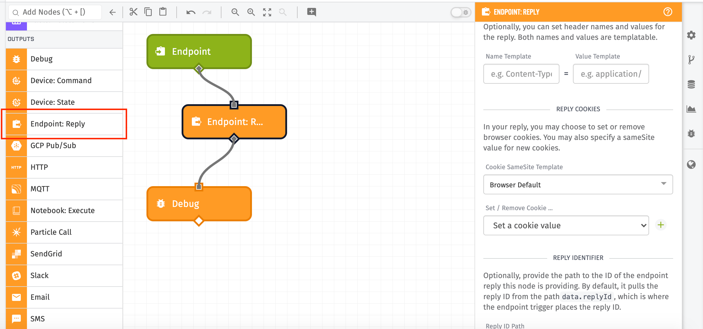

Experience Endpoint Reply Node
The Experience Endpoint Reply Node allows a workflow to create and send an HTTP response to an endpoint HTTP request. This node can be used with both experience and application workflows, although the configuration for each differs slightly. Note: we recommend only using this node in experience workflows, to take advantage of the built in experience versioning.
There are four ways that you can use the Experience Endpoint Reply Node: send a custom response, send a page render, send a redirect, or create a server side event stream (SSE). In the first three cases (excluding SSE Streams), you also have control over response headers. The three nodes also have some helpers for setting and removing cookies, so that you do not have to configure the cookie header manually.

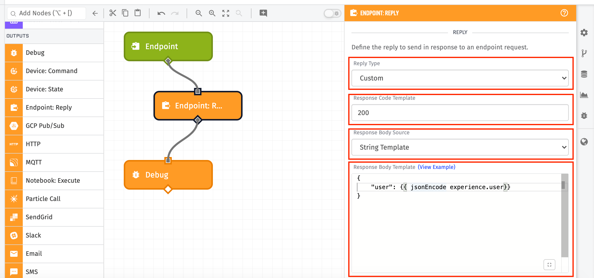

Custom Response
If you choose Custom, you have full control over the response code and body of the response.
In the above example, the response code is set to 200, although that field is templatable and so can be configured from the current payload. It is expected to resolve to a valid response code number, and if it does not, the reply will default to a response code of 200.
The body of the reply can be set either as a string template or as a payload path. In the above example, it is a string template that resolves to a string of JSON. If payload path is chosen and the payload path points to an object, that object is stringified JSON string for use as the body. The body is allowed to be empty, if no body is desired on the reply.

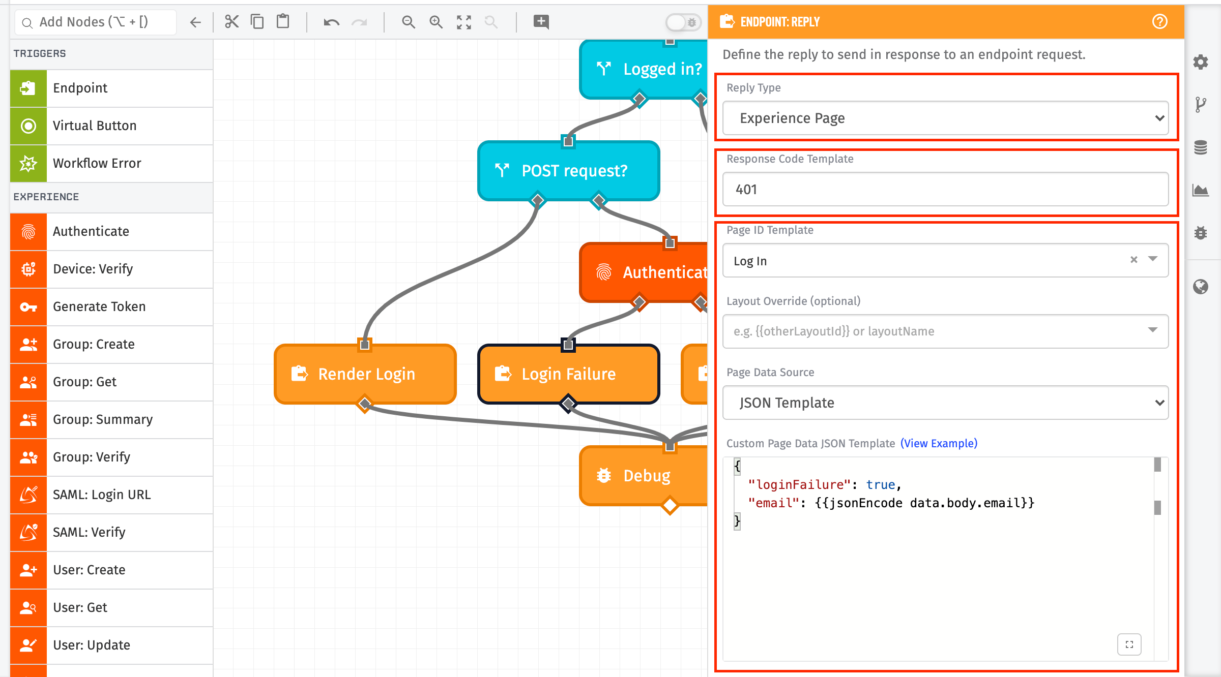

Experience Page Response
The Experience Page reply type enables you to use Experience Views for replying to endpoint requests. In the case of an experience page reply, you still have control over the response code (just like custom), but the body of the response comes from rendering an experience page.
To do this, you choose what page to render (this field does accept templates), and you can optionally override the default layout for the selected page if you need to. Once you have chosen the page to render, you can then choose what data to pass along to the page as the data that will be available during the render. There are four choices here:
- None: No custom data will be made available during the render. This means the
pageDatavariable in the page render context will not exist. - Payload Path: The value at the given payload path will be placed at
pageDatain the page render context. - JSON Template: The value is expected to be a JSON template which will be the object placed placed at
pageDatain the page render context. - Full Payload: The entire current payload will be placed at
In all cases, there is a significant amount of data available in a page render by default. The above only changes the pageData variable on that basic context object.

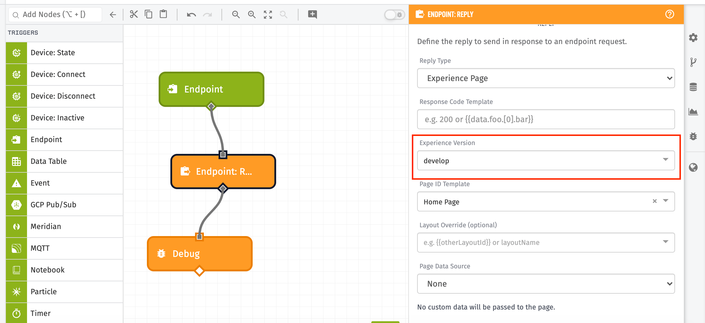

The configuration for the Endpoint Trigger for an application workflow is slightly more complicated. Because application workflows are not versioned with your experience, you will need to select the version of your experience you want to use when choosing an experience page to render. By default this is the develop version:

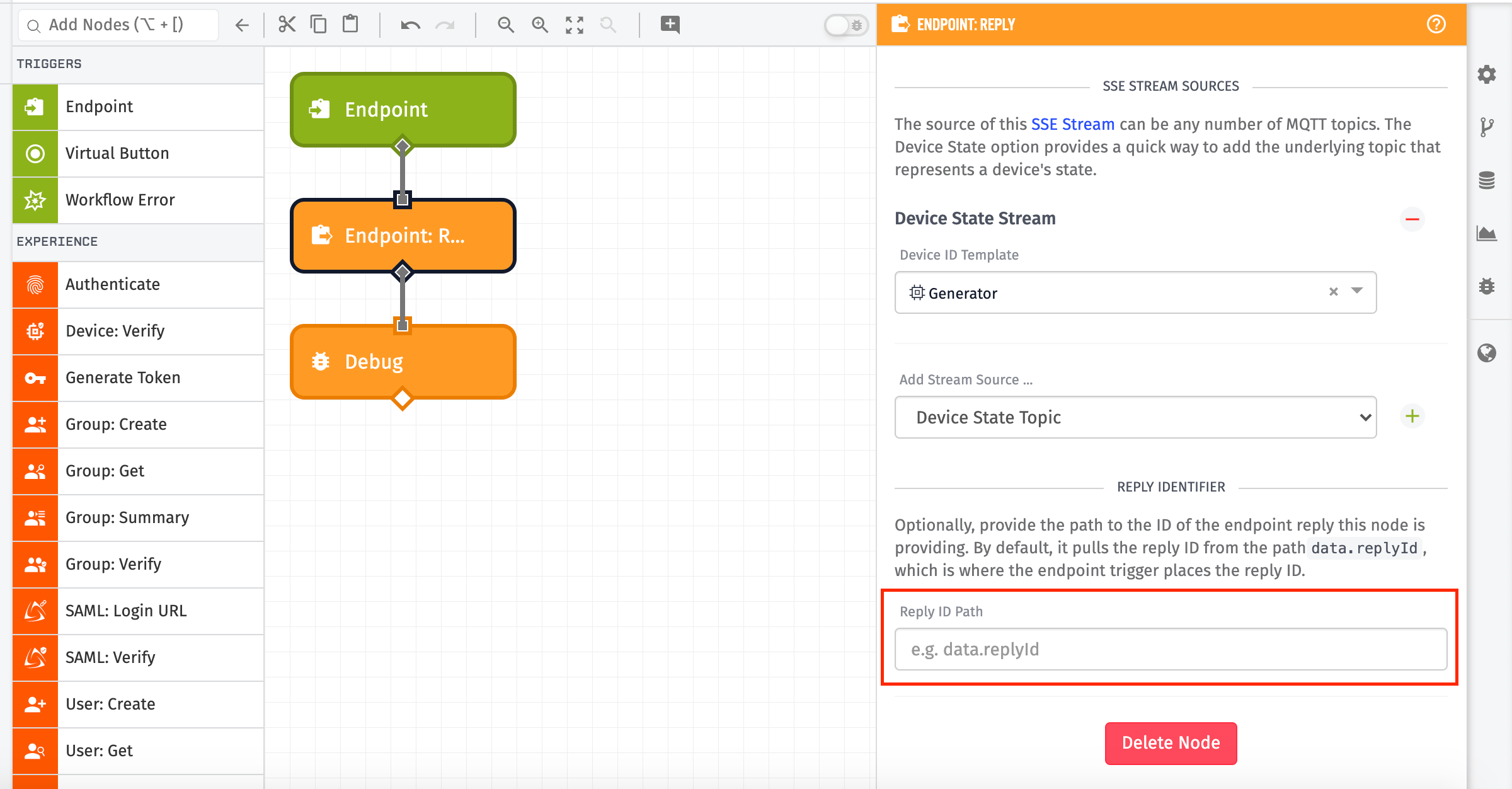

SSE Stream Sources
If you wish to consume streaming device data within an Experience Page, you can select one or multiple streaming sources through the SSE Stream reply type. Select Device State Topic as the source in order to stream state data or select a Custom Topic providing a valid MQTT topic to stream from. In order to access the SSE (server-sent events) data after configuring the node you will need three elements:
- An Experience Endpoint using the GET method with "No Static Reply" for the Endpoint Trigger. e.g.
GET /my_endpoint/stream - An Experience Page with a JavaScript EventSource object pointing to the Endpoint.
const evtSource = new EventSource(https://appID.onlosant.com/my_endpoint/stream) - Within the same Experience Page's JavaScript, an event listener for the 'mqttMessage' event.
evtSource.addEventListener('mqttMessage', function(data) { // do something... })
Note: Custom Headers and Cookies are not available for SSE Streams.
See a more detailed example configuration here: Streaming Endpoint Example.

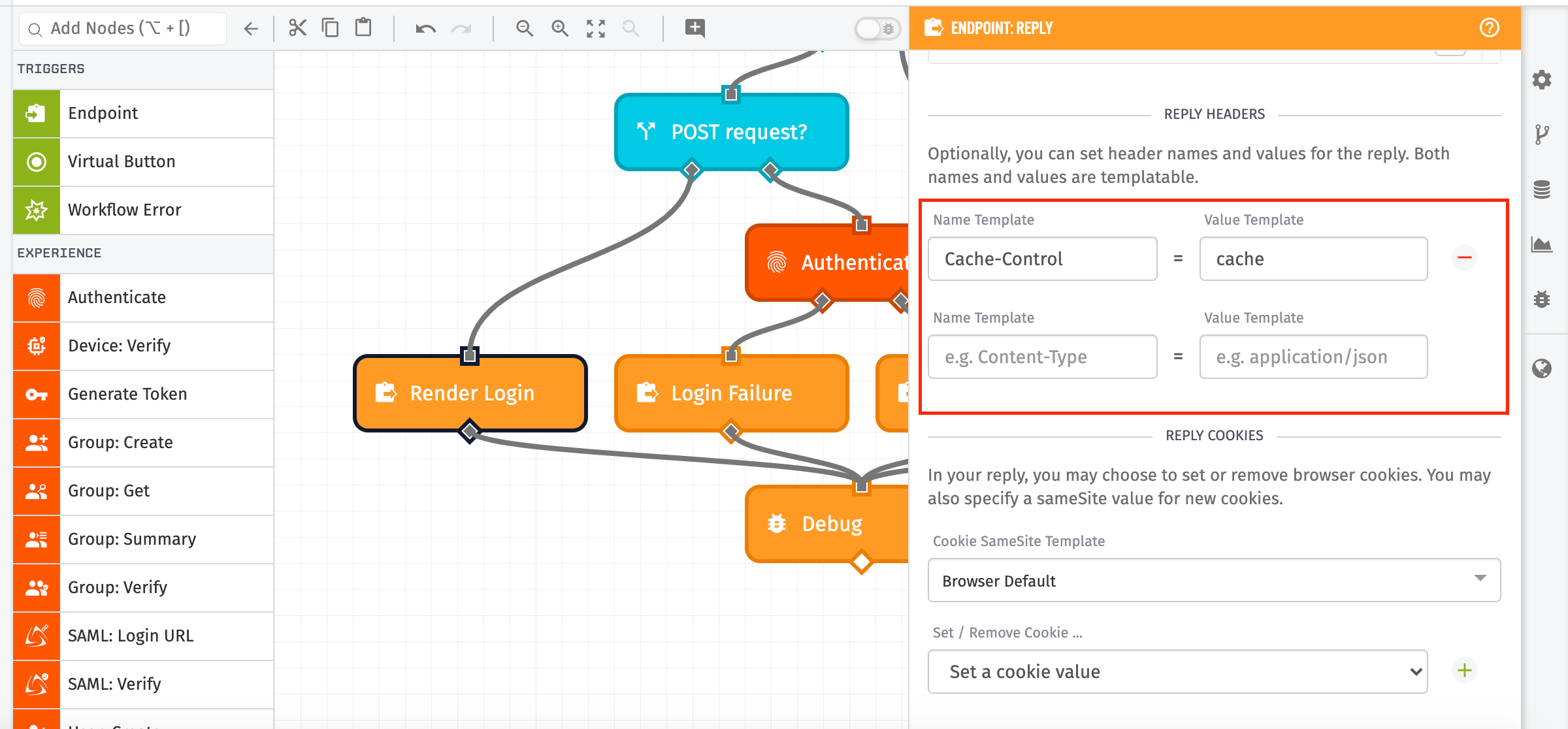

Headers
Arbitrary headers can also be set on the reply. Both the header name and value fields are templatable, so they are configurable based on the payload. In the example above, only one header field is set - Cache-Control is set to cache.
In the case of a custom reply, remember to set the Content-Type header - Losant does not try and automatically determine the content type of the body of the reply.
