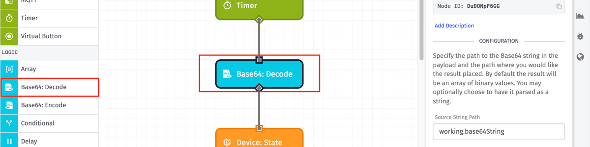

Base64: Decode Node
The Base64: Decode Node allows you to decode a Base64 string in the payload and store it elsewhere in the payload for later use. The result will be a binary array by default.
This node is only available in Embedded Workflows. If you would like to decode a Base64 string in any of the other workflow classes, you can do so using the {{decodeBase64}} helper.
Base64: Decode Node
Configuration

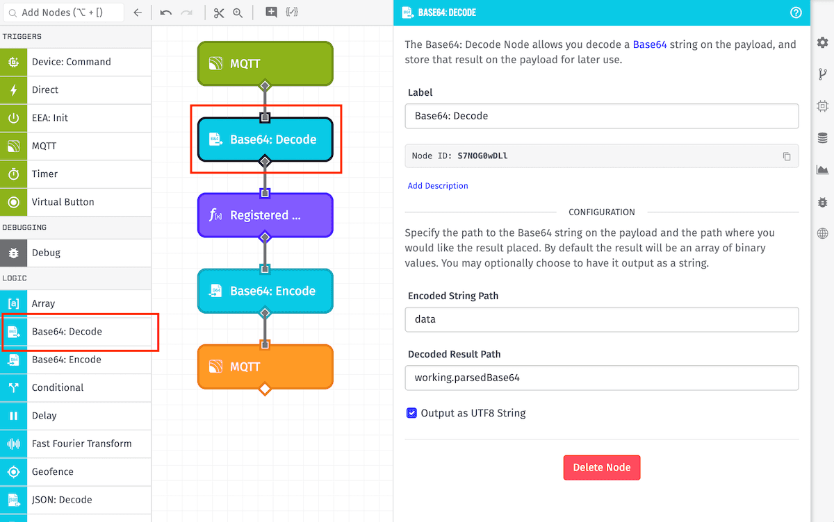

The Base64: Decode Node takes two properties for its configuration.
Source String Path
First, enter a payload path to a Base64 encoded string.
Destination Path
Next, enter a payload path where the result of the transformation should be placed. The result will be the original data before it was Base64 encoded as a binary array by default.
If the source string path is not a Base64 string, the transformation will fail.
Output as UTF-8 String
Optionally, you may want the result to be UTF-8 encoded string instead of a binary array.
