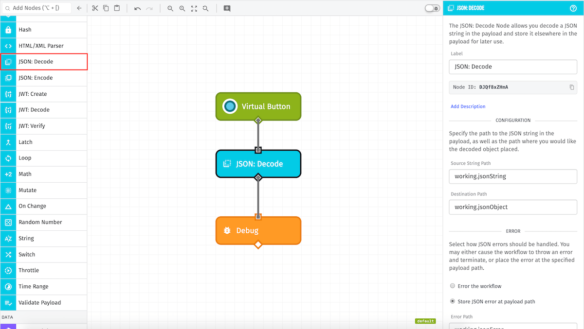

JSON Decode Node
The JSON Decode Node allows a workflow to decode a JSON string into an object on the payload.
JSON Decode Node
Node Properties

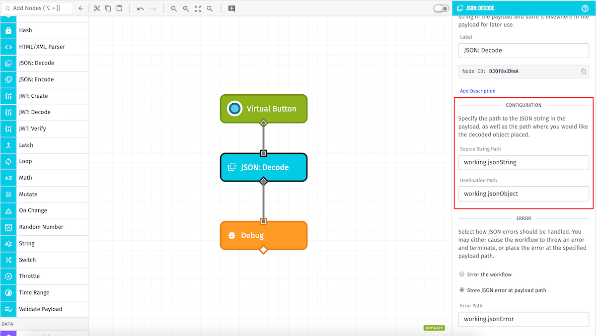

While using this node, you must configure the following properties:
Configuration
JSON Decode Node Config
There are two configuration properties for the JSON Decode Node…
  • Source String Path: the payload path to the string to decode
  • Destination Path: the payload path at which to store the result object
Note: It is possible for both paths to be the same, in which case the JSON string will be replaced by the decoded object.

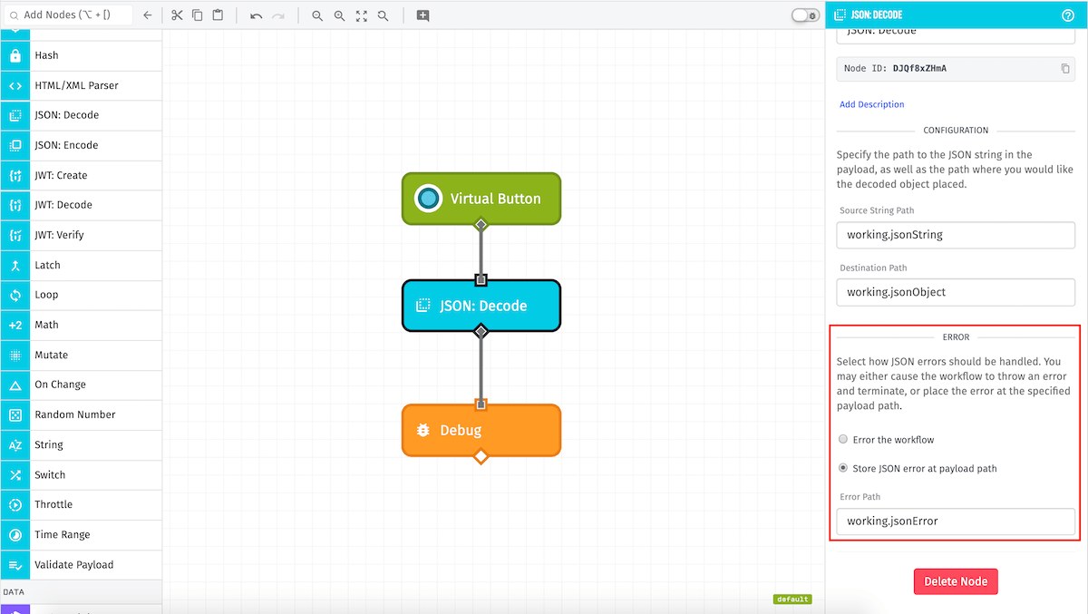

Error Configuration
JSON Decode Node Error Config
In the case that the provided JSON string fails to parse, there are two possible options for how to handle the error.
  • Error the workflow: Halt the workflow at this node, preventing further execution.
  • Store JSON error at payload path: Configure a payload path at which to store the error.
Note: For edge workflows, this option is only available on edge version 1.14.0 or higher. On older versions, the workflow will always halt on errors.
Read more about handling errors from this node below.

Node Errors
In the case that the provided JSON string fails to parse, there are two possible options. You can either error the workflow, or you can store the error at a path on the payload.
Below is an example of an error stored on the payload:
  "working": {
    "jsonError": {
      "message": "Invalid JSON source: data.jsonString",
      "type": "JSON_DECODE_NODE_ERROR"
    "jsonString": "notJson"
  "time": Fri Feb 19 2016 17:26:00 GMT-0500 (EST),
