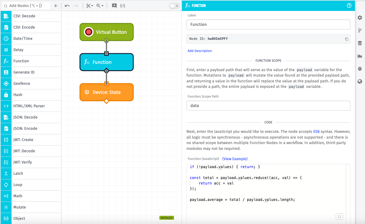

The Function Node configuration takes two inputs.
Function Scope
Optionally, you may provide a payload path to serve as the value of the payload variable in the function script. If a path is not provided, the entire workflow payload will act as the payload variable value. The maximum amount of data that can be provided to a Function Node is 5MB. By specifying a path, you can reduce the size of the data to only that which you need, leading to better workflow performance and less risk of exceeding the 5MB limit. In the screenshot above, the Function Node is scoped to the data path on the workflow's payload.
Note: For Edge Workflows, the ability to provide a Function Scope Path is only available in GEA version 1.30.0 or higher.
Code
The provided code must be valid JavaScript and the web interface provides a code editor with syntax highlighting. ES5 and ES6 syntax are both valid. Other ECMAScript specifications are not supported.
Example: Calculating an Average
if(payload.values?.length > 0) {
const total = payload.values.reduce((acc, val) => {
return acc + val;
payload.average = total / payload.values.length;
The example code above is calculating the average across values in an array. The result is being placed at payload.average. The payload variable points to whatever was passed in as the Function Scope. If no function scope was provided, payload points to the entire workflow payload object. In this example, the function scope was set to data. This means that when the node completes, the result will placed back on the payload at data.average (since payload is scoped to data).

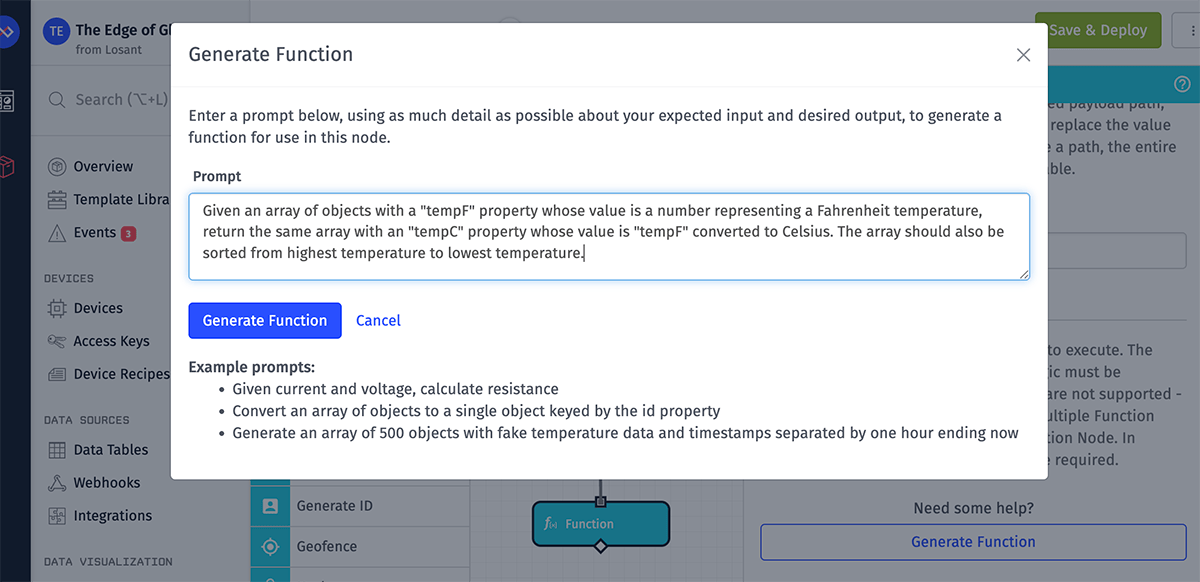

Generate Code Suggestions
To assist workflow developers, Losant exposes an AI-powered service that accepts a prompt and optionally an example payload, and returns JavaScript that can mutate the workflow payload as directed in the prompt. The model backing the code generator is trained on millions of lines of code from a variety of general-purpose use cases, making the service especially useful for unit conversions; data sorting, filtering, and re-mapping; randomized data generators; and more.
Requesting a Code Suggestion
To generate a function, click the "Request AI Code Generation" button above the Function Node's code editor. Doing so will display a modal where you may enter a prompt and choose a payload to serve as context for the prompt.
Function Node Generator Input
Providing a Prompt
Enter one or more sentences in plain language describing the function you would like to generate. The more detail you can provide about what you would like the Function Node to accomplish, the more likely the generated code will handle your use case as desired.
Providing a Payload
For best results, provide an example payload along with your prompt. This additional context will help the AI assistant generate code that matches your prompt.

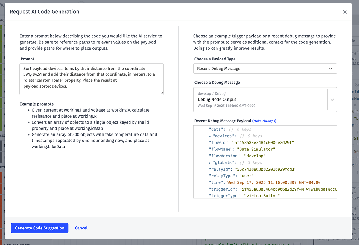

Payloads may be provided one of three ways ...
  1. Workflow Trigger: Select one of the triggers currently on the workflow stage. The example payload in the trigger's editor will be provided as context. Note, however, that the actual payload differs across every workflow execution and may be mutated by other workflow nodes preceding the Function Node. This is the default option when there are no messages in the workflow debug log.
  2. Workflow Debug Message: Select a recent debug message out of your workflow debug log. If there are any messages in the log when the modal opens, this most recent message is the default selection. While this is most often the best option, bear in mind the following ...
    • The debug message reflects the payload at the time that the message was generated. If the message came from a Debug Node that follows the Function Node, the payload may have been mutated by other nodes between the Function Node and the Debug Node and thus the payload would not reflect the actual context of the Function Node. For best results, choose a debug message generated by a Debug Node immediately preceding the Function Node.
    • The message may have been generated through a workflow path that does not connect to the Function Node at all, in which case the payload may have deviated completely from what is expected when executing the Function Node.
    • If the Function Node's scope is limited and the debug message's scope does not match that scope, the value of the payload variable in the returned code will not match the value of the variable that is actually provided to the Function Node.
    • Similarly, if the chosen debug message comes from a Debug Node with a scoped payload value, the Function Node's payload variable will not match the value from the selected debug message.
  3. Custom Payload: Enter a custom object to serve as the payload variable's value when generating code for the node. When selecting the option, the payload will be autofilled with the value from the previous selection - be it an example workflow trigger or a debug message. You may then modify that value to reflect the expected input to the Function Node.

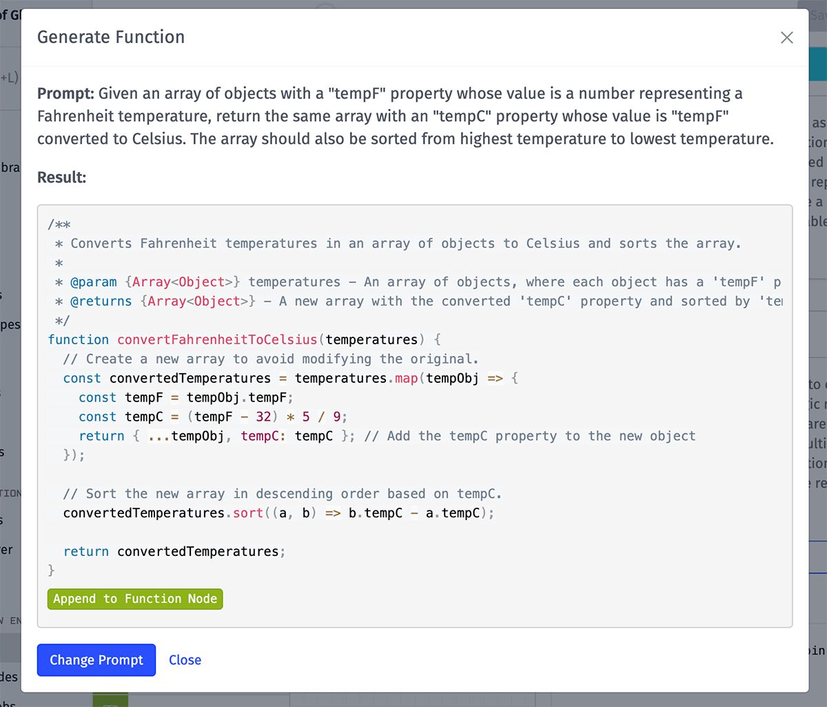

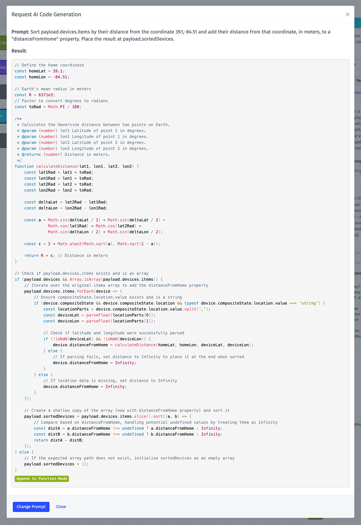

Using the Suggested Code
Once ready, click the "Generate Code Suggestion" button at the bottom of the modal return a code example matching the provided prompt and sample payload context. Depending on your inputs, the result may include some instructions along with a code sample that can be applied to the Function Node.
Function Node Generated Output

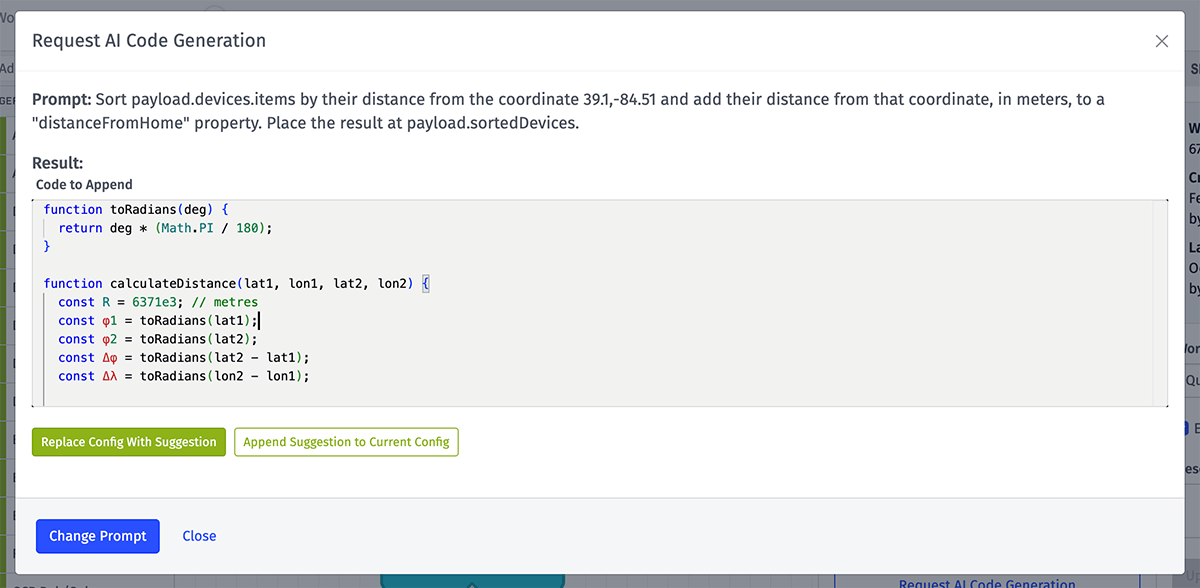

Beneath the output are two buttons:
  • Replace Config with Suggestion: Pressing this will overwrite any current code in the Function Node with the returned suggestion and will close the modal.
  • Append Suggestion to Current Config: Pressing this will add the suggestion beneath any code that is currently in the Function Node and will close the modal.
If you are not satisfied with the result, click "Change Prompt" to try again with a different prompt and/or example context.
