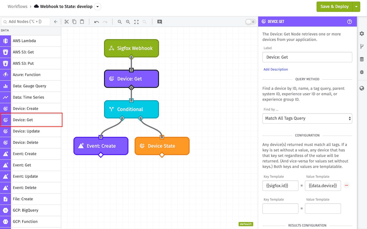

Device: Get Node
The Device: Get Node allows a workflow to retrieve one or more Devices from the current application and add them to the current workflow payload.
The configuration for the Device: Get Node requires a query method and parameters to find a device connected to Losant.

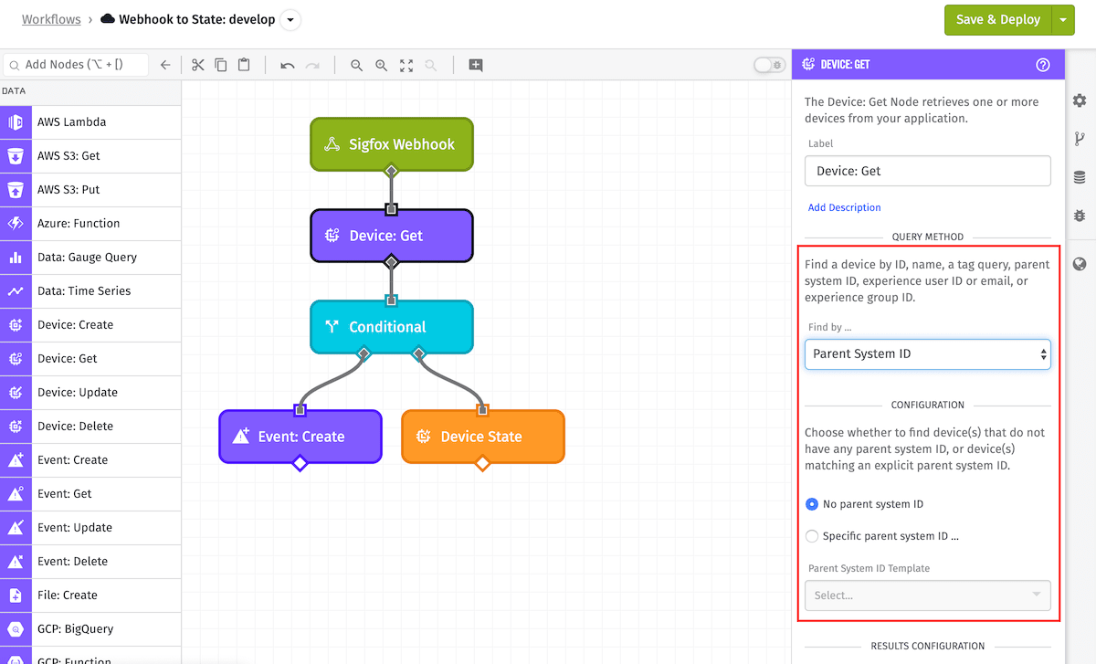

Query Method
The first step is selecting a query method to use to find a device or group of devices. The Device: Get Node has many query options, allow of which allow for direct input or providing string templates referencing values on the payload:
- Device ID: Provide the ID of a specific device to retrieve.
- Device Name: Input a specific device's name to retrieve it.
- Match All Tags Query: Provide one or more tag queries to retrieve matching devices. Any device(s) returned will match all tags in the query. The key and/or value can be hardcoded or derived from a property on the current payload, and you may provide only a key or only a value.
- Match Any Tags Query: This is similar to the "Match All Tags Query" option, except matching devices can match against any of the provided key/value pairs.
- Parent System ID: Select a System Parent ID to retrieve any devices which are children of a particular System or of no parent Systems.
- Experience Group ID: Select an Experience Group ID to retrieve any devices associated with that group or any of its children.
- Experience User ID or Email: Input an Experience User ID or email to retrieve any devices that the user is associated with by their Experience Groups.
- Advanced Query: You can also form an advanced query to allow more complex device matching than the above methods.
Depending on the query method selected, you are able to input the specific Device ID, Device Name, or the tag key/value pairs to find a device or group of devices.
