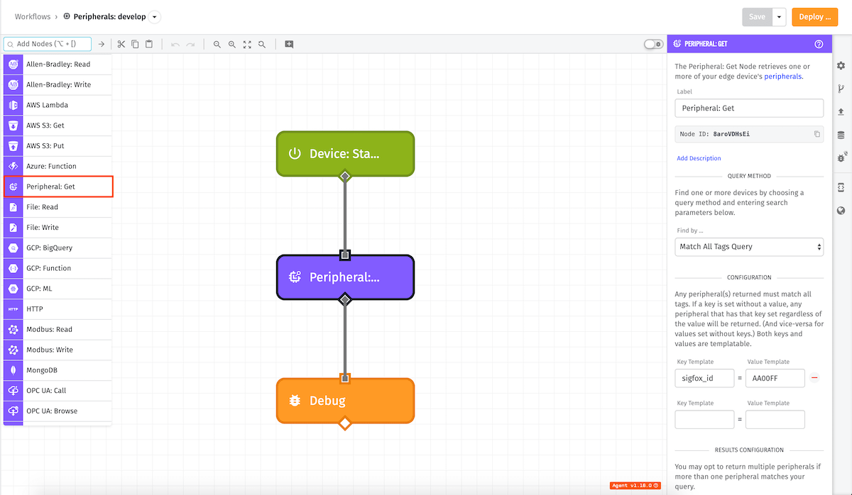

Peripheral: Get Node
The Peripheral: Get Node allows a Gateway Edge Agent (GEA) to retrieve one or more of the current edge device's Peripheral Devices and add them to the current workflow payload.
Node Usage

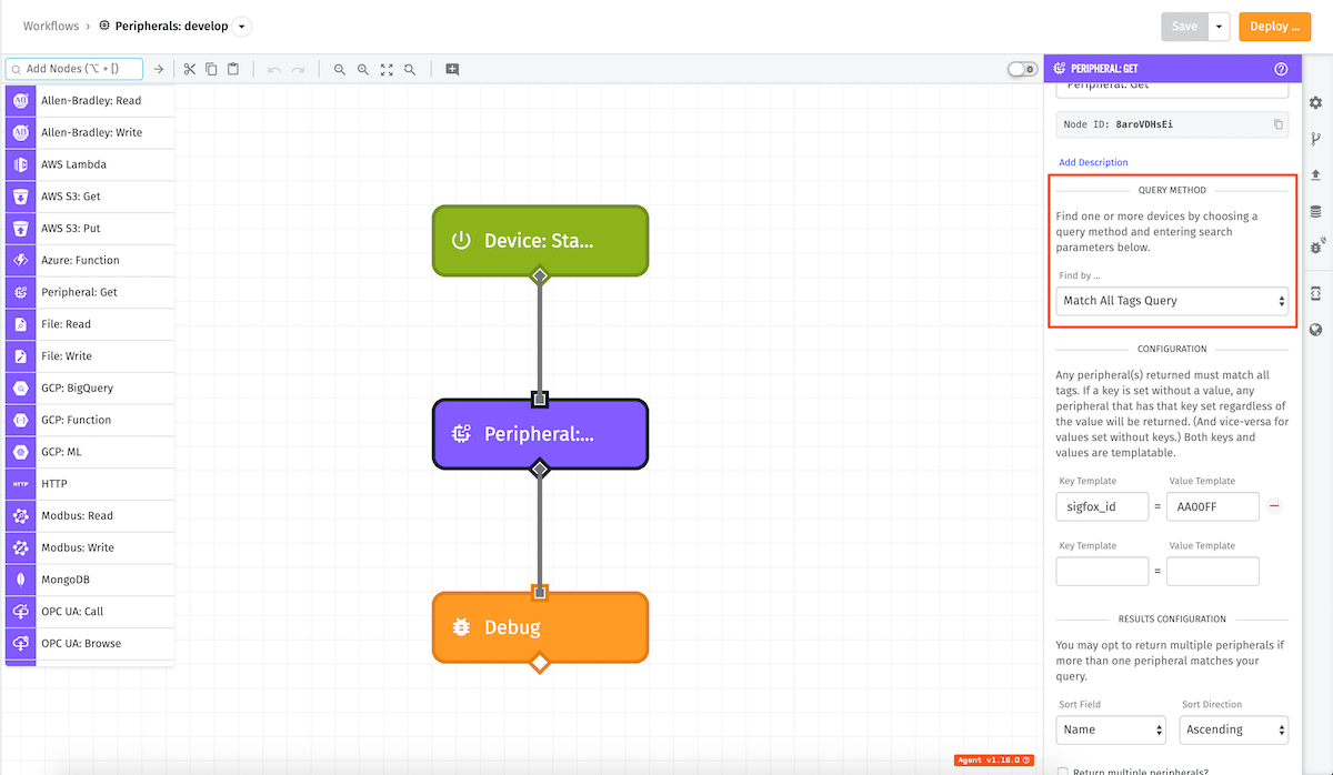

Query Method
To find one or more peripheral devices, a query method must be defined.
The Peripheral: Get Node has four query options:

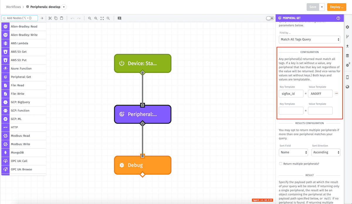

Device ID: You can input a specific device's ID to retrieve it or use a value on the payload. The ID can be hardcoded in the workflow editor or derived from a property on the current payload.
Device Name: You can input a specific device's name to retrieve it or use a value on the payload. The name can be hardcoded in the workflow editor or derived from a property on the current payload.
Match All Tags Query: You can set specific tag key/value pairs to retrieve one or more devices. Any device(s) returned will match all tags in the query. The key/value can be hardcoded or derived from a property on the current payload.
You may also query by key only or value only. If a key is set without a value, any device that has that key set regardless of the value will be returned. If a value is set without a key, any device that has that value set regardless of the key will be returned.
Match Any Tags Query: You can set specific tag key/value pairs to retrieve one or more devices. Any device(s) returned will match any tags in the query. The key/value can be hardcoded or derived from a property on the current payload.
Depending on the query method selected, you are able to input the specific Device ID, Device Name, or the tag key/value pairs to find a device or group of devices.

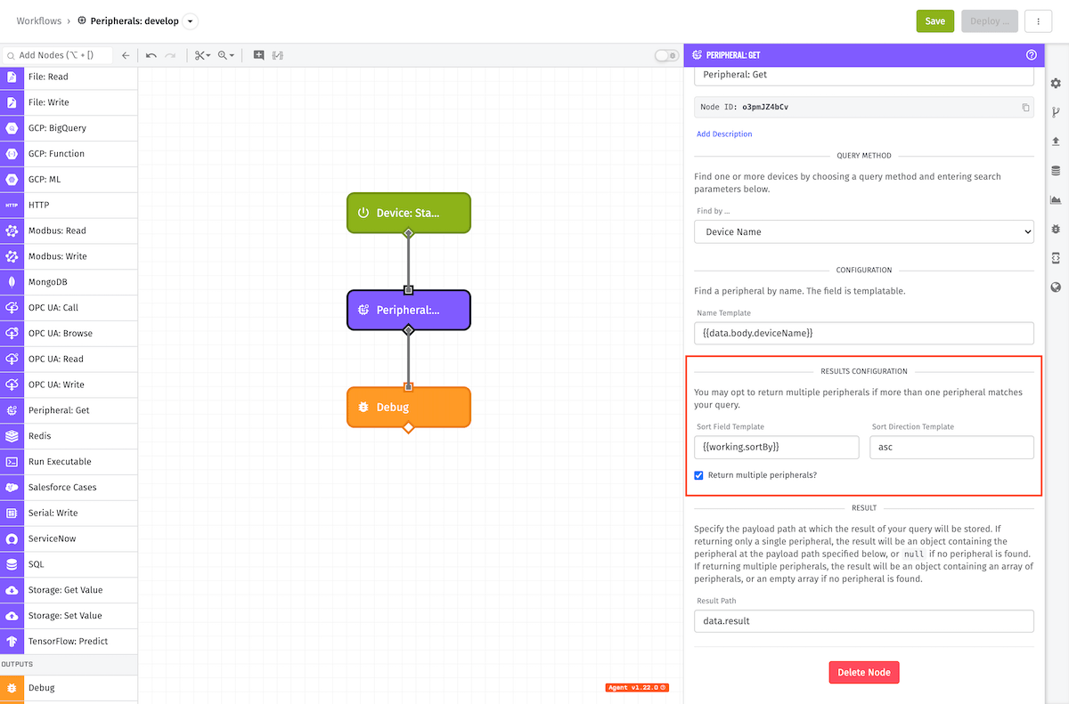

Results Configuration
For each query method aside from Device ID an extra set of properties will appear beside the tags input:
Return multiple devices?: If you want to return multiple devices from this query, check this box. This also alters the return type of the result. If checked and nothing is found, an empty array will be returned instead of
null. If checked and one or more devices have been found they will be returned as an array. -
Sort Field: This is the field on the group to sort the results by. By default, this field is
name. The following are the valid sort fields:name,id,creationDate, orlastUpdated. As of Gateway Edge Agent v1.22.0, this field can also accept any valid template. -
Sort Direction: This is the field that tells the sort field which direction to sort in. By default, this field is
Ascending. As of Gateway Edge Agent v1.22.0, the valid options areasc(default) for ascending ordescfor descending, or any valid template.
NOTE: Sorting options affect the result -- even when returning a single device.

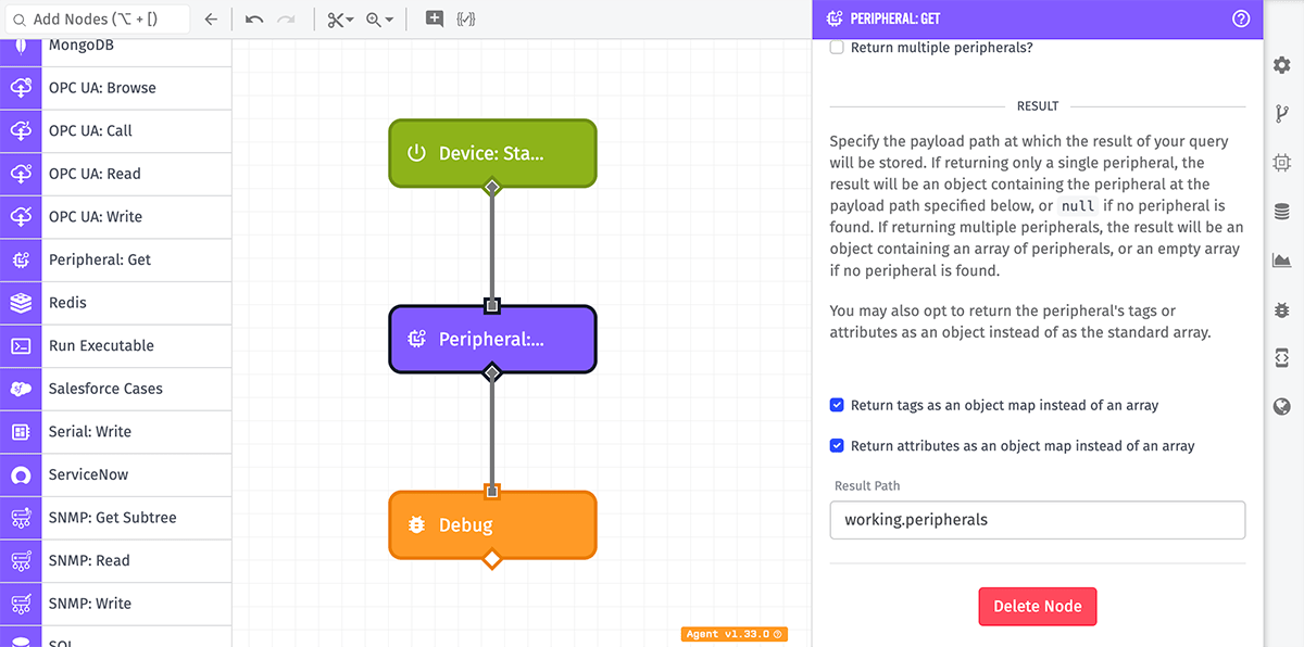

Result
It is required you specify where on the payload path you want the device or group of devices to be stored.
Starting with Gateway Edge Agent v1.33.0, you also have the option to return each device's attributes and tags either as an object map, or as an array of objects. Prior GEA versions always return attributes as an array and tags as an object map.
