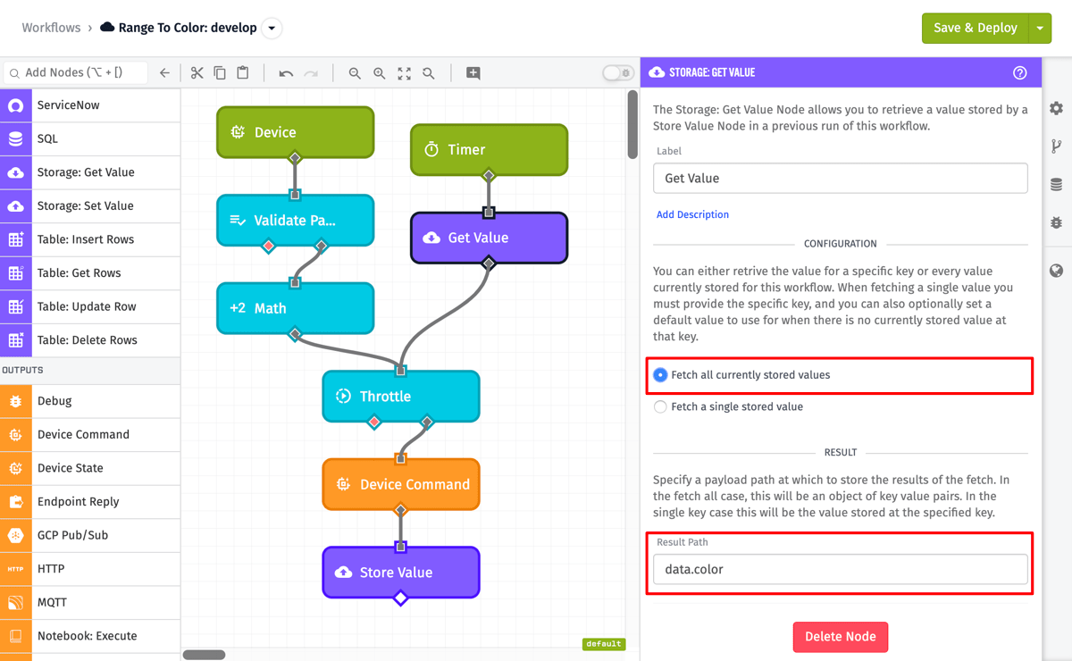

Fetch All Currently Stored Values
When this option is selected, there is only one additional option to configure.
- Result Path: This is the payload path at which the workflow will place the retrieval result. The workflow will create an object of key/value pairs, where the keys are the workflow storage keys and the values are the associated workflow storage values. That object will be placed at this specified spot on the payload.
For Edge Workflows, the ability to fetch all storage values is only available in Gateway Edge Agent Version 1.10.0 and higher.

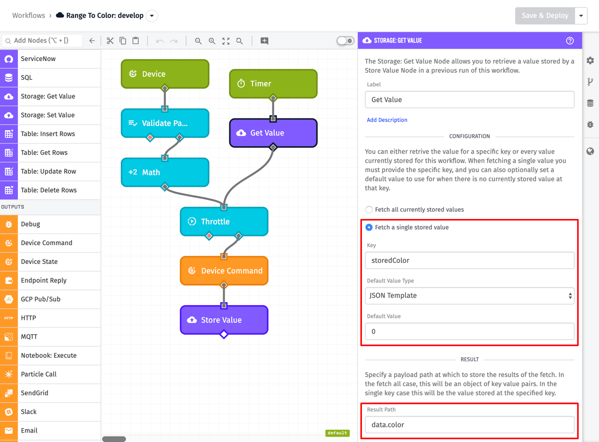

Fetch a Single Stored Value
When this option is selected, there are a few additional options to configure.
Key: This is the particular workflow storage key to retrieve. It can be a string template, and while it can be an arbitrary string, it should match the identifier of a previously stored value - i.e., the identifier used in the configuration of a Storage: Set Value Node.
Default Value Type: This defines how the workflow should interpret the
Default Valuefield. The options arePayload Path,String Template, andJSON Template. -
Default Value: When the
Keygiven is not actually a key that exists in the workflow storage, this value comes into play. The value of this field will be used as the default value for theKeywhen it is not found.- When
Default Value TypeisString Template, the value in this field renders as a string template against your payload, and the resulting string is used as the default value. - When the type is
Payload Path, the value in this field will be treated as a payload path, and whatever exists at that payload path will be used as the default value. - When the type is
JSON Template, the value in this field will be templated and then parsed as a JSON object, and that will be used as the default value.
- When
Result Path: This is the payload path at which the workflow will place the retrieval result. This will either be the value actually retrieved from workflow storage, or the resolved default value if requested key did not exist.
In the above "Fetch a single stored value" example, the workflow will fetch the value stored under the identifier storedColor, and will place that value in the current payload at the path data.color. If there is no value stored under storedColor, the workflow will place 0 in data.color instead.
